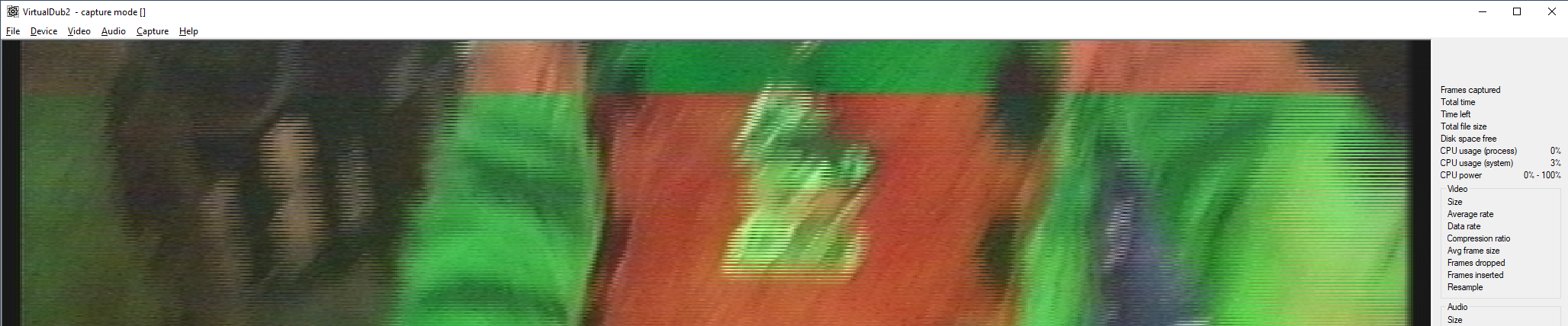

  1. I recently got myself a Sony EV-S9000E PAL to capture Hi8 tapes, because playback on my Sony CCD-VX1E has vertical colour line issues.
    But have ran into this issue where often there is a green bar at the top of the frame. Sometimes it is there, it seems to disappear and reappear between scenes/when the camera was stop and started during recording. Also tried with a tape from someone else and exact same issue. Turning on the TBC function makes the bar smaller but it is still there. And I prefer to use my external TBC.
    See attachments. NR/TBC turned off, EDIT set to ON and straight into my capture card.
    Looked inside after removing top cover and caps that I could see all look good.
    Any advice? Hints for repair?

  5. Really appreciate your thoughts Dellsam and Brad!
    As for the back tension, maybe? Would have to look into the service manual to see if it is easy to adjust. Tho with my own tapes that I recorded new I dont see any flagging or waving issues. Just the bar at the top.
    [Attachment 87214 - Click to enlarge]
    Also interesting here, the top bar seems to invert the colours? Red becomes green and the green parts become red.
    The effect is more extreme depending on the amount of saturated colours in the framing.

  8. Originally Posted by Dutchsteammachine View Post
    If the bar doesn't change width it would be easy to invert the colors in AviSynth.

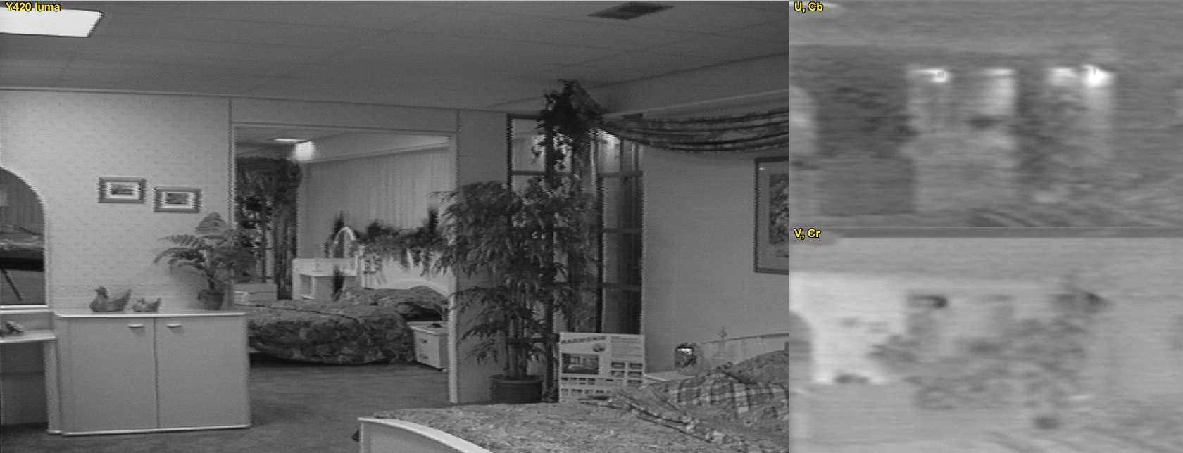

  18. It seems like Y and U are ok and the problem is with the V channel
    [Attachment 87222 - Click to enlarge]
