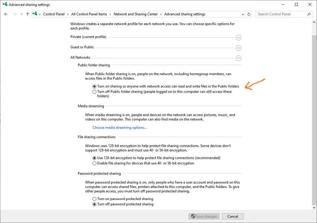

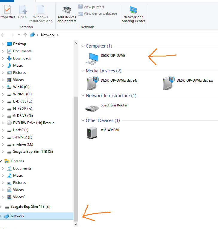

    Hi Lon, see these screen grabs

    Mar 2008

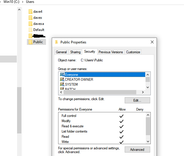

    Regarding the security setting for Public, check that "Everyone" has full access

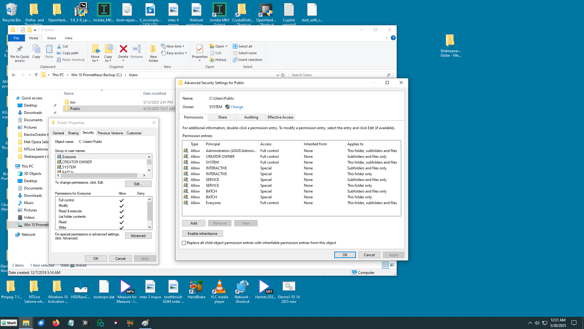

  7. I can't see anything odd here in the screen shot.
    You will see the "advanced" detail open as well.
Name:	Public folder properties.png
    Mar 2008
    it shouldn't be necessary to manually change it. That "Everyone" access gets set when you turn on public folder sharing as in the third image of post #2

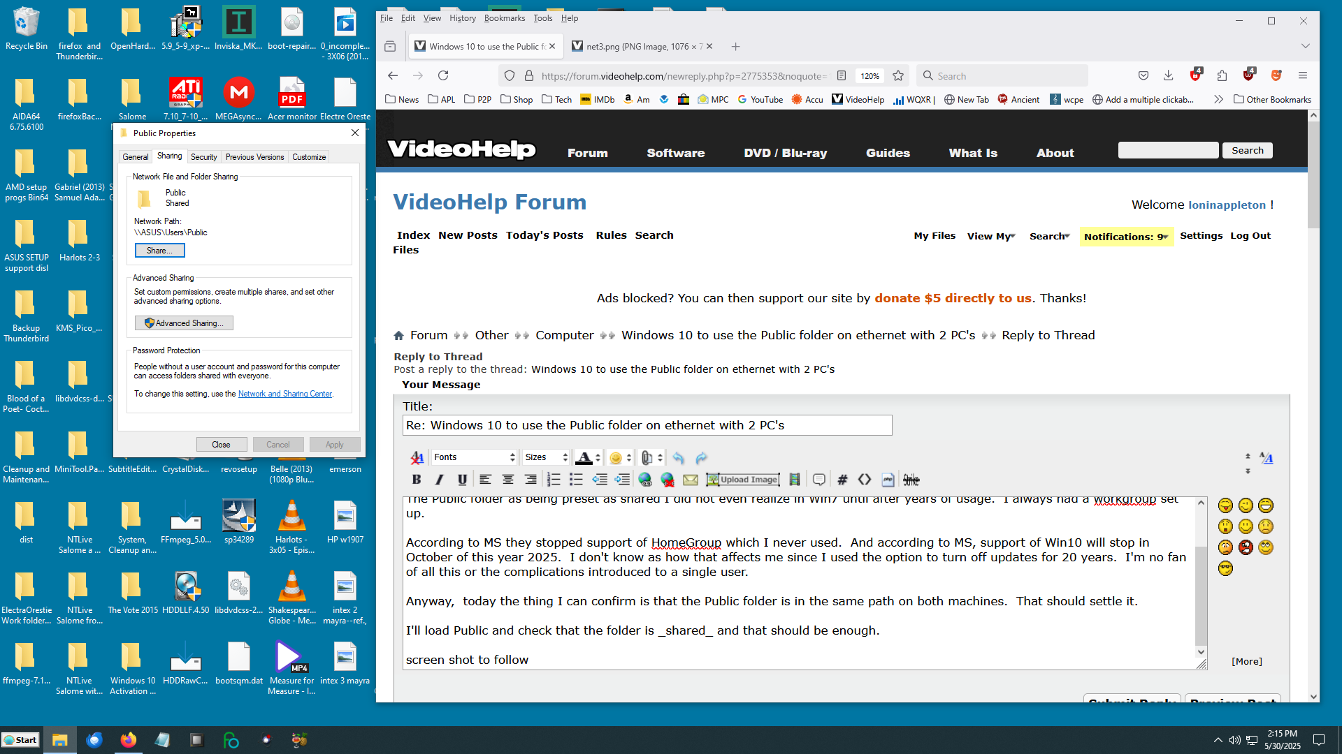

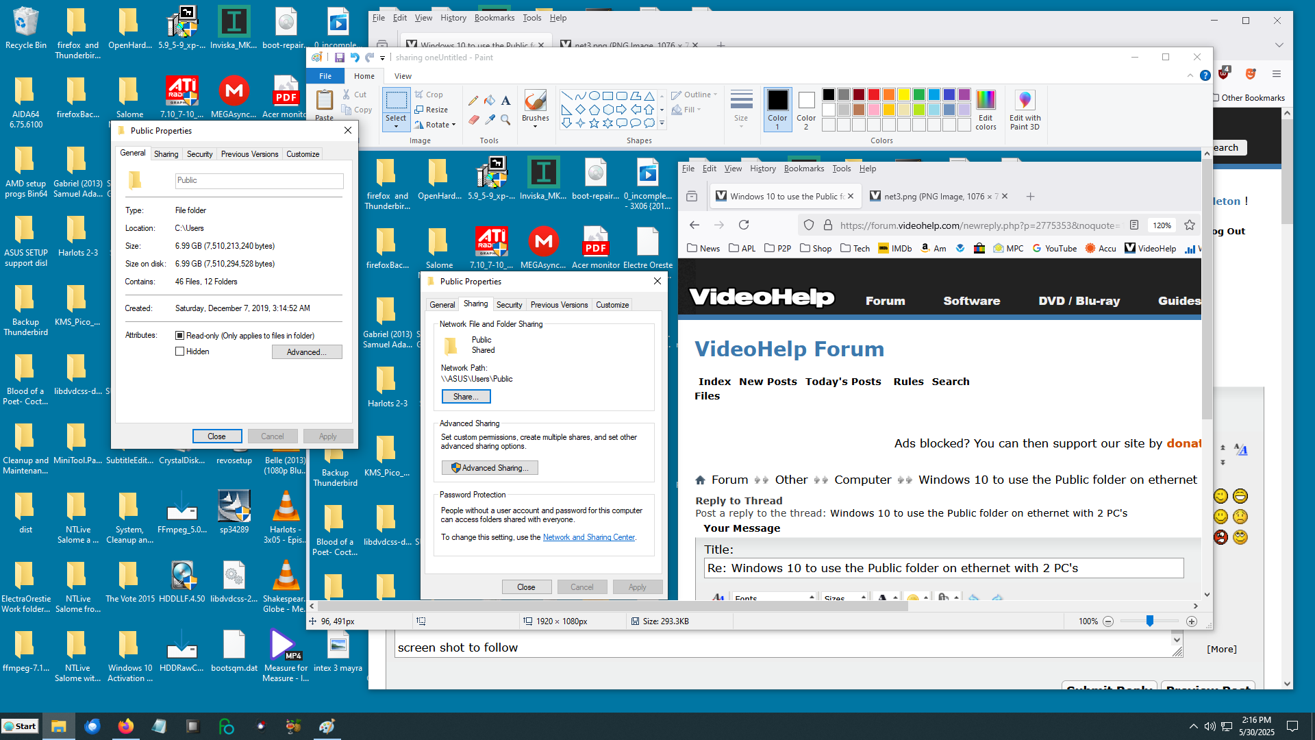

    I'll load Public and check that the folder is _shared_ and that should be enough.
    Screen shots to follow. The second one shows Public is read only which must be a problem. I looked for a way to get it read write but couldn't see where to do it.
Name:	sharing oneUntitled.png
    Mar 2008
    That "read only" attribute on the general tab is normal, all folders show that

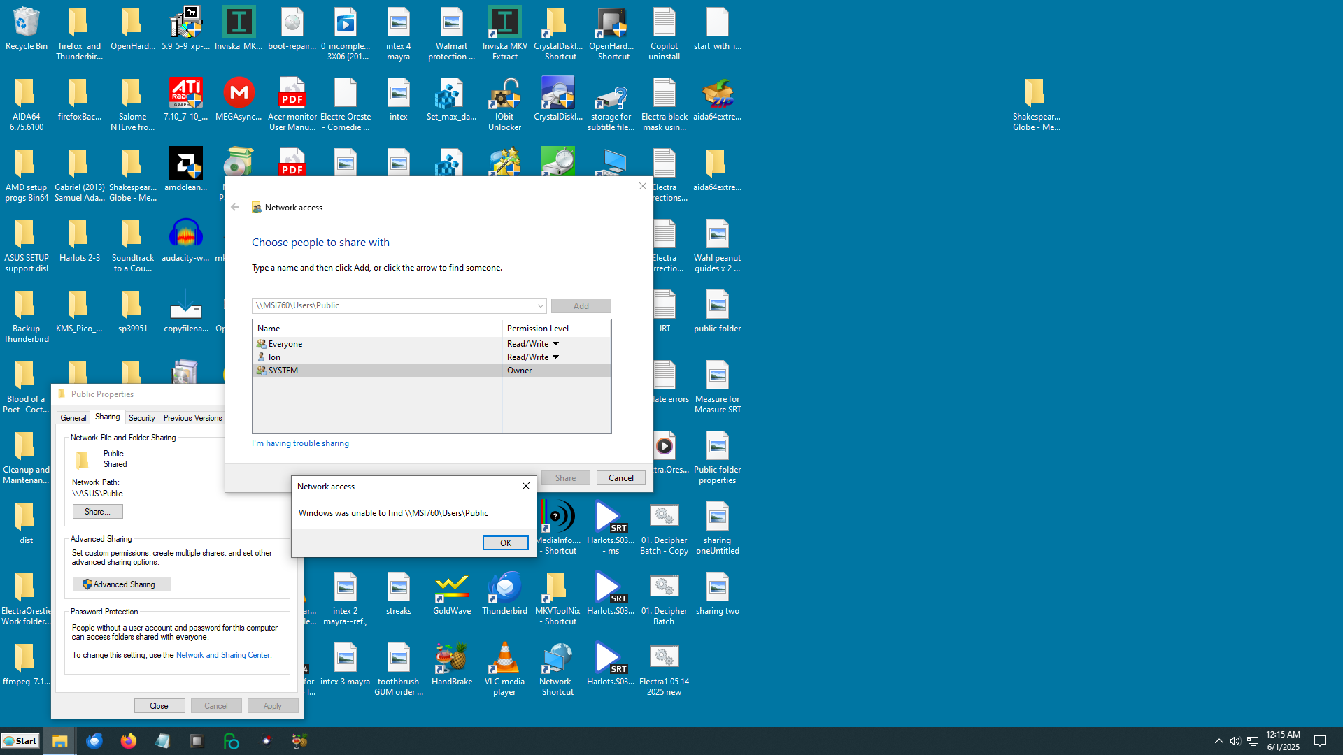

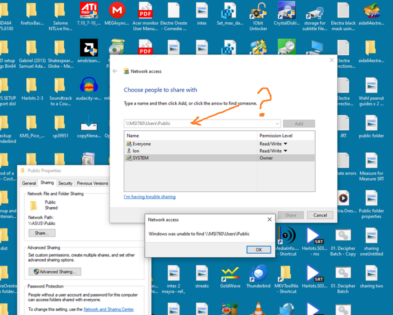

  13. Here's my last posting on this, then consider it closed.
    The screen shot shows the share screen and the code should be simple enough based on the Properties.
    So the two machine names are ASUS and MSI760 the Share screen shows what is given as a blank box to fill in. I never knew what to do with it since no HINT is given as to how the code should look. If anyone has any idea on how to correct this ok. Logic tells me that's all that's needed. Both Public folders are located in \\ machine name\Users\Public.
    But as you can see it gives a can't find error. I'm out of ideas and don't want any more frustration on it.

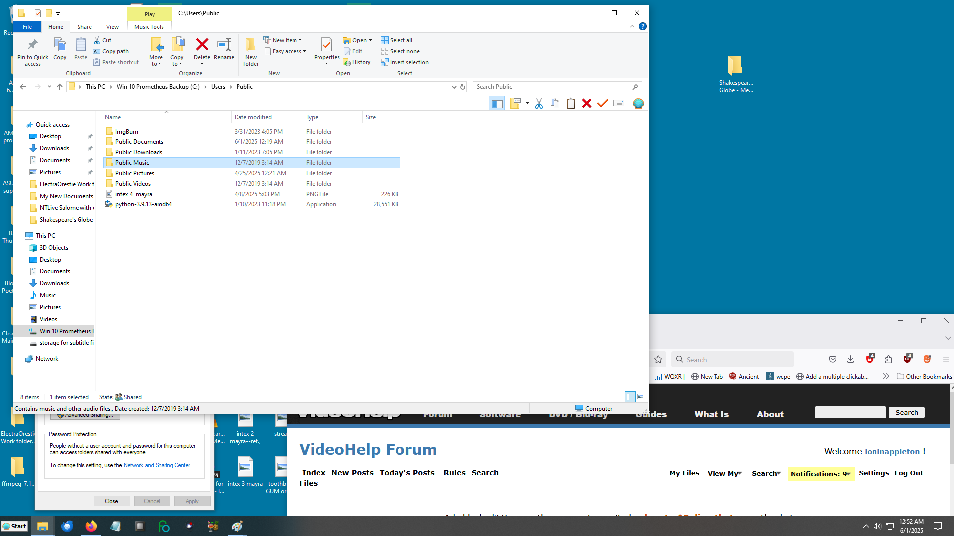

  14. I have seen the error at Asus Network Path on the Properties. But when I go to public, the Path shows this in the screen shot:
    So I don't know what is right. It could be a syntax/code problem but that's all I can do. The computer name is ASUS like it shows.
    The SSD name is as shown: Win10 Prometheus Backup C:
    But it cannot be both.
  15. the black and white sheet does not show a sample of what's in the share with box and the path. If someone would provide a working instance of that in a screen shot, I think I'd have it.

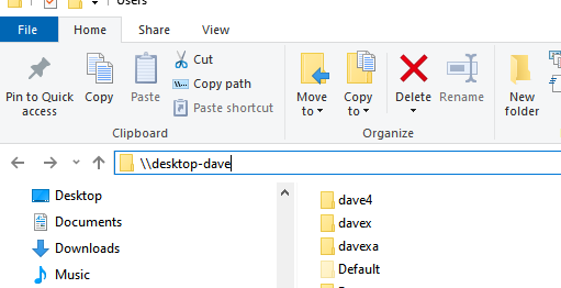

    Mar 2008
    Are you talking about this field? I think you misunderstood something, that's not where you enter the path,
    that's where you add the user (eg. "davex") or class of user (eg. "Adminstrators") and define their access.
    Since "everyone" is there (as I mentioned earlier) and it has read write access, nothing to do here.
    Can you access the other PC using the \\pc_name\ in Explorer ?
    Does each PC at least show itself in Explorer/Network?

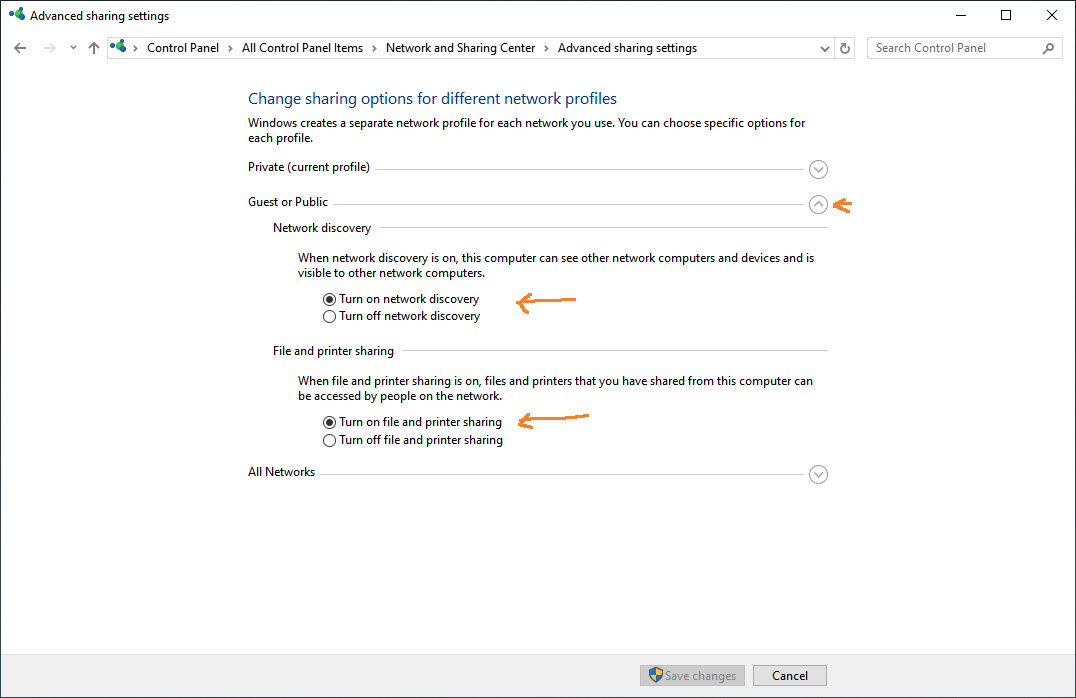

    Mar 2008

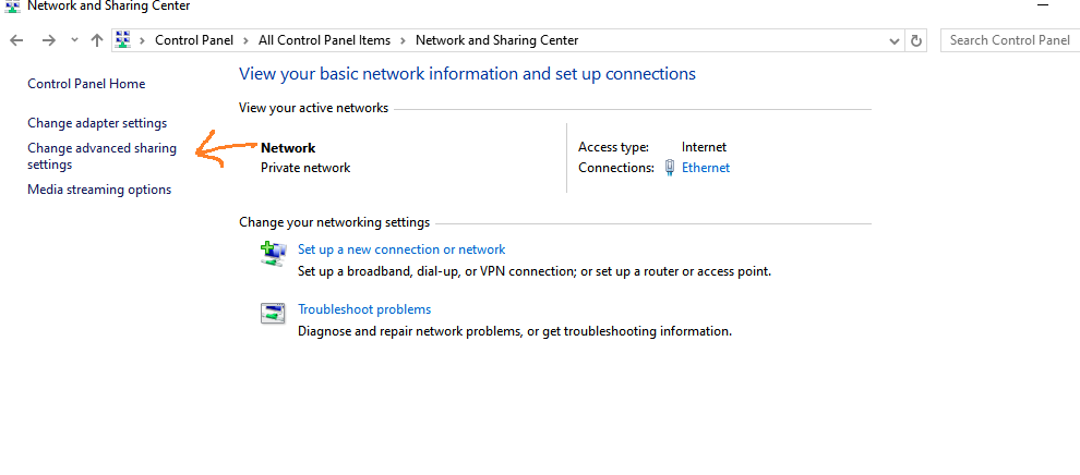

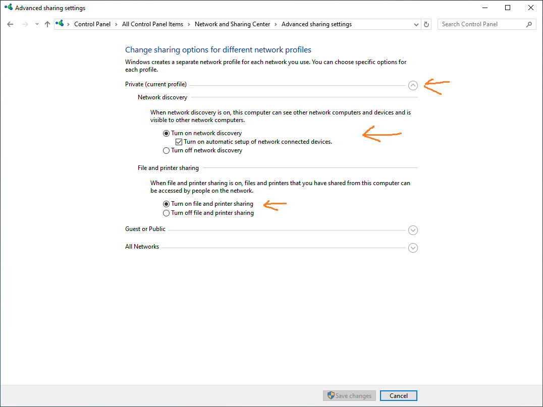

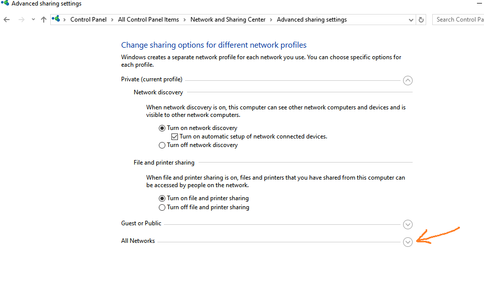

    Make sure these two things are on:
    Also, are you running any third party A/V or Firewall?
