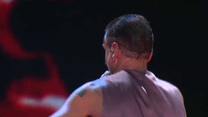

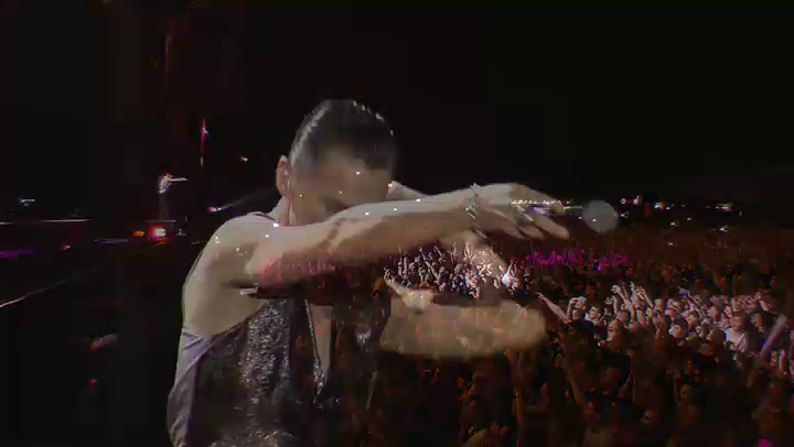

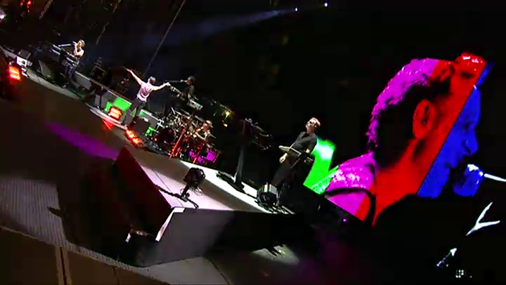

  1. I need help with this video, which was extracted from a web stream from a few years ago, and for its time (2013) it looks really awful.
    I'm open to any advice, including AI tools or anything that can significantly improve this video clip, since the compression artifacts and resolution make it unwatchable by today's standards.
    [Attachment 87169 - Click to enlarge]
    [Attachment 87170 - Click to enlarge]
    [Attachment 87171 - Click to enlarge]
    I will send a long clip, since it's necessary (I believe) to see all the compression artifacts this video fragment is suffering from in general.
    I even believe it has more artifacts, but it would be impossible for me to upload the entire concert.
    Video
