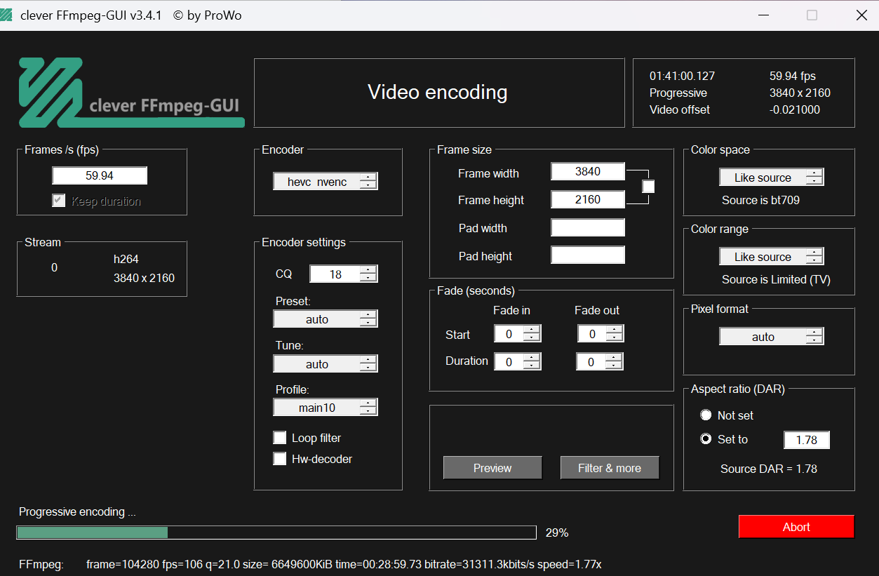

    Here are the settings I used in Clever-FFmpeg-GUI for this:
    [Attachment 87221 - Click to enlarge]
    The ffmpeg GUI output file has worse frame duplication, in this pattern (which might just be random):
