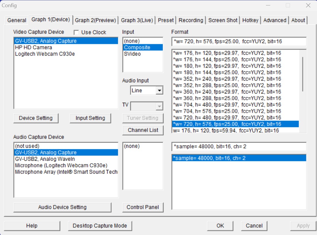

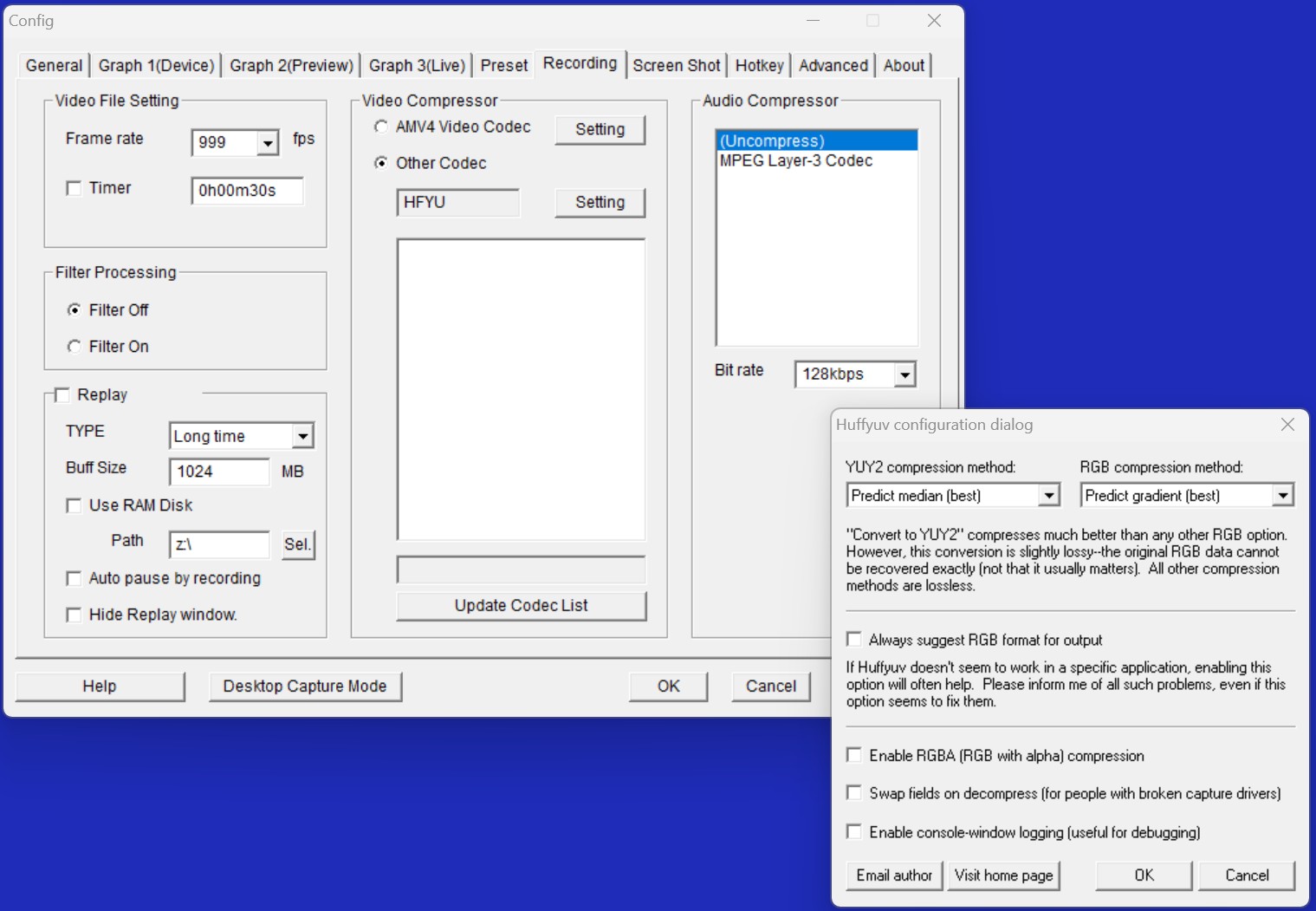

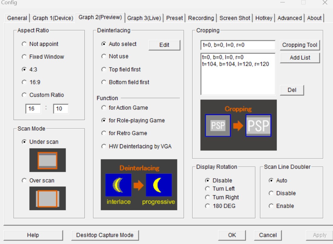

    Before I start the main work of digitising all the VHS stuff, I'd like to sense check my settings.
    I'm happy with the results, but it occurs to me that i haven't tried all the options - and whilst of course I should, I'm also aware that it could take hours to test and check every variation of the many many options within AmaRecTV, and it also occurs to me that this may not be necessary if some kind soul here already knows the answers.....
    I've left pretty much all settings at default - but had to change a couple to get the source to show up properly in AmaRecTV.
    Here are two screenshots of the main two settings pages - any thoughts?
    1. 4:3 PAL is 720x576, right?
    2. In the 3rd pic, the Recording tab - Video File Setting is set to a frame rate of 999 fps (which was the default) and it does work as is but clearly it's not capturing at that frame rate - perhaps it should be set to 25 ?
    3. I've left deinterlacing as auto, which shows up as this txt file when you click Edit
    ; AmaRecTV Live Auto Deinterlacing List --------------
    ; *** Format ***
    ; - ip
    ; p : Progressiv (not use deinterlacing).
    ; i : Interlace (use deinterlaceing).
    ; - field
    ; t : Top field first.
    ; b : Bottom field first.
    ; a : Auto select.
    ; ip field min_w min_h min_fps max_w max_h max_fps
    #DATA p t 1280 720 59.94 1280 720 60.00 ; D4
    #DATA p t 720 480 59.94 720 480 60.00 ; D2
    #DATA p t 1920 1080 23.97 1920 1080 24.00 ; 1920@24p
    #DATA p t 1920 1080 59.94 1920 1080 60.00 ; D5
    #DATA i t 0 625 25.00 1920 625 25.00 ; PAL
    #DATA i b 0 525 29.97 1920 525 30.00 ; NTSC
    #DATA i b 720 486 29.97 720 486 30.00 ; D1 for Intensity Pro
    #DATA i a 720 480 29.97 1920 1080 50.00 ; Other interlace format
    #END
    Many thanks indeed if you can help out here!
    Cheers.

    @Wills, lossless capture is pretty simple: it's either Yes, or it doesn't happen at all. That said, there are a few settings in Amarec.
    I've made a detailed guide here. Those HUFF settings look OK.
  26. Thanks Alwyn!
    I compared all of my settings with the ones in your super helpful guide, and the only difference was the Deinterlacing which I had on AutoSelect but is set to Not Use in your guide, so I'll compare and contrast between off and on.
    Cheers!
