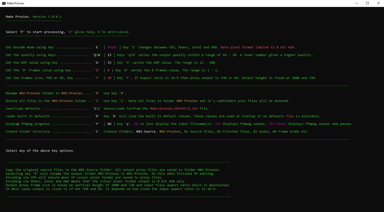

    The XTREE command initially creates the correct empty folder structure in the output folder.
    The ffmpeg command syntax is an arbitrary scaling, but can be anything else.
    I am including here my own effort ("Version-2.bat") and one posted on inet ("reconvert.bat") but both fail.

    Mistakes and retries are the name of the game. Ive spent a bit of time integrating it into my batch file (make proxies) this evening and more mistakes, but tiredness mainly. I should finish all by tomorrow.
    I really appreciate you doing that as I wasn’t sure it could be done.

    "What does that script actually do?"
    It's purpose is to convert a source folder "#01-Source" of files to proxy versions similar to HD or FHD frame size and save to destination folder "#02-Proxies" .
    By way of explanation as to your issues running it.
    There is an included "# Readme 1st, using Win 11, false AV positives etc.txt" text file in the zip which should be read first especially if using Win 11.
    I normally obfuscate the batch file and then convert to .exe using "Advanced Bat To Exe util" .
    The Advanced Bat To Exe util does sometimes raise false positives. I wasn't aware that the obfuscation part does.
    Of the more than 2 dozen small utils I have packaged in this way only 2 have failed to "take" with the "Advanced Bat To Exe util" . In both cases I simply left off that part, and so less issues with false positives.
    Those 2 are my "Updater" and "Make proxies" utils.
    So the zip I made available dispenses with the .exe conversion, yet there must be something in the obfuscation that Windows Defender isn't happy with.
    Below is version 1.0.0.1 Small tiny changes since earlier upload.
    [Attachment 87089 - Click to enlarge]

    The screenshot above it, very basic, only keys, no mouse. Going to bed.
