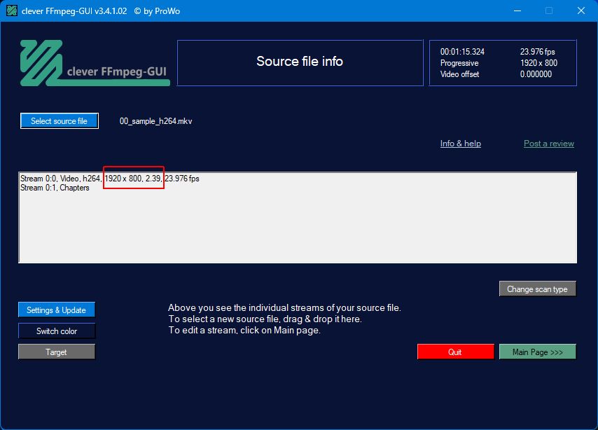

  10. Originally Posted by Sharc View Post
    ...and it's still wrong, because the movie has a DAR of 2.39 and not 2.4...
    Not really. He cropped like 3840:1600 = 2.40:1 and resized to 1920:800 = 2.40:1. Even though the movie AR might in fact be 2.39:1 he has to set the DAR as 2.4:1 because of the way how he cropped and the pixel aspect ratio of the source is 1:1 square pixels.
    Anyway, splitting hairs
    The correct source AR can be applied, even with 1920x800, as you can see here:
    [Attachment 87011 - Click to enlarge]
