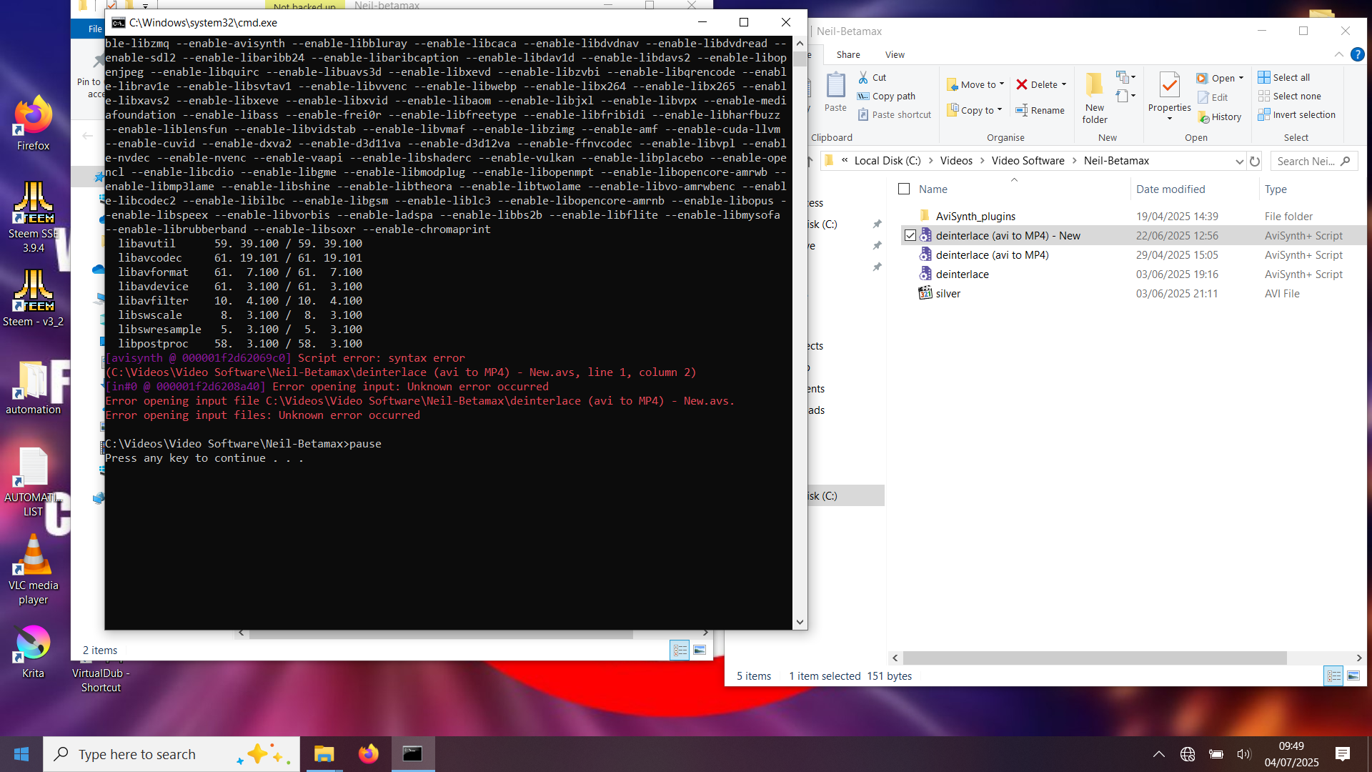

    and Silver.mp4 will appear in your ffmpeg folder.
    You should just need to copy that command, then paste it into the command line you get in the cmd prompt window and hit Enter to run it. You shouldn't have to remove that "user" stuff.
    Not that I'm an expert, but see how that goes.

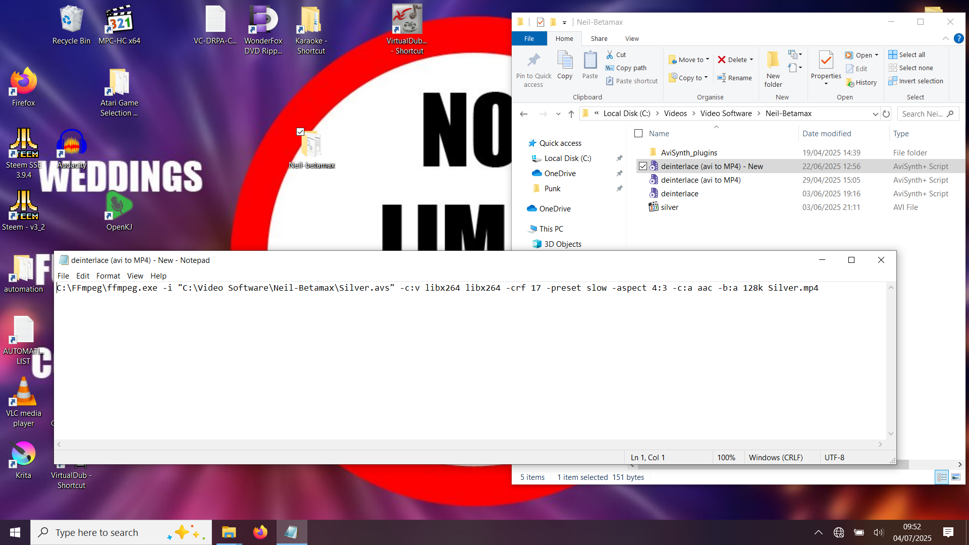

    Hi Alwyn, thanks for the tips.
    I tried my best to follow what you suggested, I'm unsure if I got it right.
    I made a new AVS file which reads as follows:
    C:\FFmpeg\ffmpeg.exe -i "C:\Videos\Video Software\Neil-Betamax\Silver.avs" -c:v libx264 -crf 17 -preset slow -aspect 4:3 -c:a aac -b:a 128k Silver.mp4
    This AVS file is stored in C:\Videos\Video Software\Neil-Betamax
    I pasted the exact code into Command Prompt, but it reads like this...
    C:\Users\User>C:\FFmpeg\ffmpeg.exe -i "C:\Videos\Video Software\Neil-Betamax\Silver.avs" -c:v libx264 -crf 17 -preset slow -aspect 4:3 -c:a aac -b:a 128k Silver.mp4
    I tried to delete User\User> in Command Prompt, but it won't allow me to delete User\User> when I try to make it just read as C:\FFmpeg (etc).
    When I type L, the cursor won't move left beyond User>, the furthest point I can type a command past is from C:\Users\User>_ - So I can't get it to read from C:\_ .
    The error I get in Command Prompt Reads in red as follows: (after a lot of coding prints in white, with ffmpeg version etc listed)
    Error opening input: No such file or directory
    Error opening input file C:\Video Software\Neil-Betamax\Silver.avs
    Error opening imput files: No such file or directory

    Here's two screenshots of what's happening at this end. I'm hoping there might be something obvious to anyone more familiar with this process which can help identify where I'm going wrong.
    After I dragged & dropped the AVS file into encode file, screenshot 1 shows the result in CMD.
    When I pressed a key to continue, CMD closed down & nothing else happened.
    The second screenshot is what my AVS file looks like when I open it in text reader.

  20. No, your second screenshot is not the .avs script, it's a commandline.
    You should just drag and drop the file Silver.avs onto the encode.cmd.
    (Post your silver.avs)

    Thanks Sharc, & Thanks Lollo too! It works!
    I think I got confused somewhere along the lines, but now I can see the result I can go back and earn a greater understanding of how this process works in better detail.
