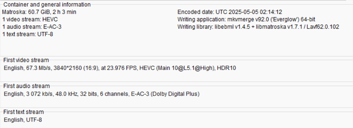

  1. Hi all,
    I'm having an issue with a video file recorded in HDR that is not playing in HDR in all players, particularly Plex, which is where I primarily watch my media. It was recorded using FFmpeg and a Blackmagic capture card. I have been recording in HDR using the same FFmpeg command and the same hardware for years like this, with no issue until now, and I can't seem to figure out the problem with this particular video file.
    MediaInfo says the video is HDR, and it plays back correctly in HDR and looks good using MPC. But Plex does not identify it as HDR and as such the colors are flat and washed out. VLC also has the same issue where the colors are flat and washed out. However PowerDVD correctly plays the video in HDR.
    Here is the MediaInfo:
    [Attachment 86942 - Click to enlarge]
    Video
    Format                                   : HEVC
    Format/Info                              : High Efficiency Video Coding
    Format profile                           : Main 10@L5.1@High
    HDR format                               : SMPTE ST 2086, HDR10 compatible
    Codec ID                                 : V_MPEGH/ISO/HEVC
    Duration                                 : 2 h 3 min
    Bit rate                                 : 67.3 Mb/s
    Width                                    : 3 840 pixels
    Height                                   : 2 160 pixels
    Frame rate mode                          : Constant
    Frame rate                               : 23.976 FPS
    Bit depth                                : 10 bits
    Bits/(Pixel*Frame)                       : 0.338
    Stream size                              : 58.0 GiB (96%)
    Writing library                          : Lavc62.1.102 hevc_nvenc
    Language                                 : English
    Default                                  : No
    Forced                                   : No
    Color range                              : Limited
    Color primaries                          : BT.2020
    Transfer characteristics                 : PQ
    Matrix coefficients                      : BT.2020 constant
    matrix_coefficients_Original             : BT.2020 non-constant
    Mastering display color primaries        : R: x=0.680000 y=0.320000, G: x=0.270000 y=0.690000, B: x=0.150000 y=0.060000, White point: x=0.312700 y=0.329000
    Mastering display luminance              : min: 0.0001 cd/m2, max: 1000 cd/m2
    Maximum Content Light Level              : 1000
    Maximum Frame-Average Light Level        : 300
    I manually entered the HDR parameters into the header using MKVToolnix and verified they were correct. I've never had this issue before. Any help would be appreciated. Thanks.

    Thanks it looks like this solved the problem. VLC showed the HDR correctly and I threw the test sample into Plex and it also identified HDR. I'm going to process the full video now and will report back if there are any issues.
