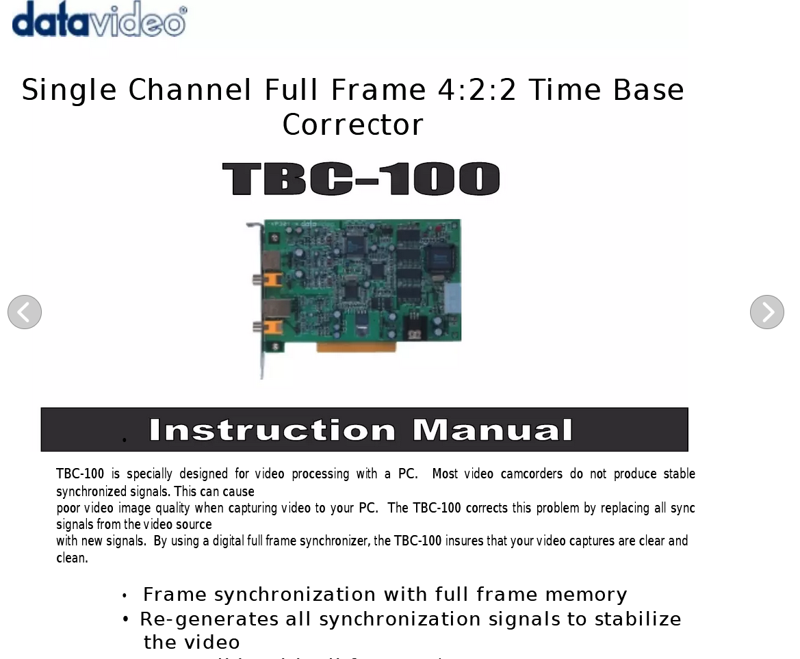

  6. So you're trying to recreate a DataVideo TBC-100 (PCI) in essence
    https://www.modesdemploi.fr/datavideo/tbc-100/mode-d-emploi
  7. @Barrythecrab - Yes, it's very sad, he was a lovely person
    @themaster1 - I didn't know Datavideo ever made a PCI card, thanks for providing that, yes would contain a lot of the functionality we are going for.
  8. Well maybe make more research before trying to reinvent the wheel. Makes sense imo.
    Not for capture.
    If you open a TBC-1000 you'll find something similar
    Emphasis here, because it's not the same.
