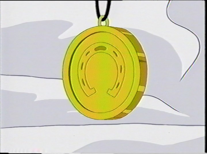

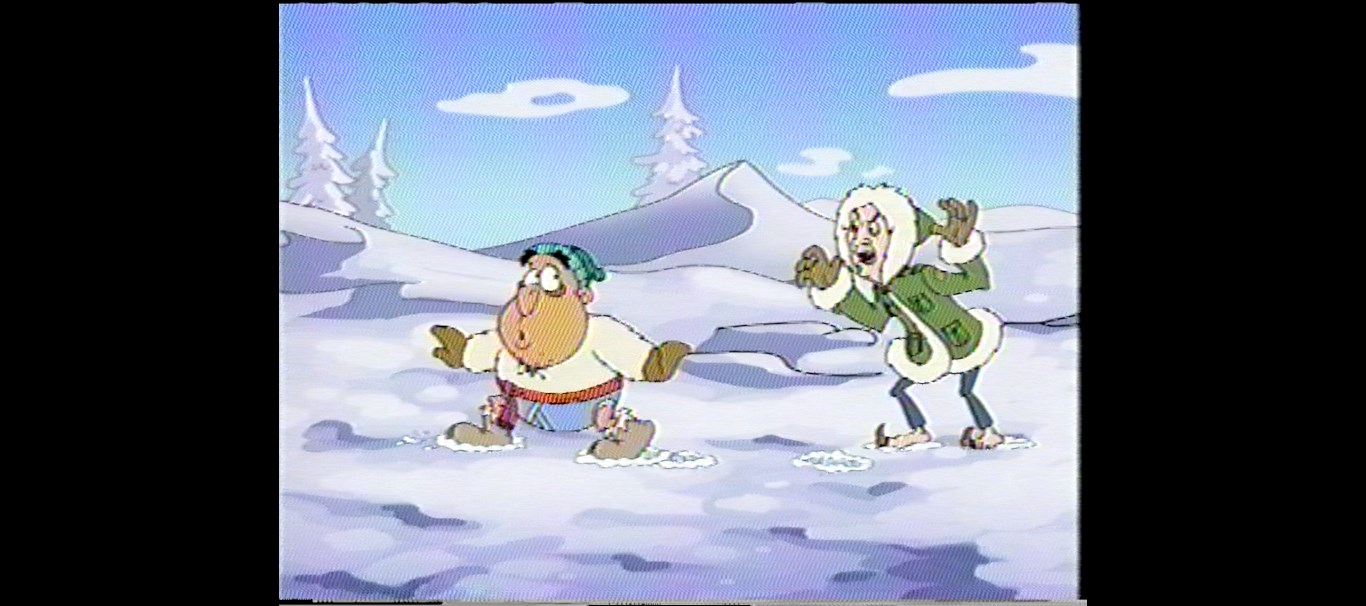

    Hello! My Hybrid version is 2025.03.09.1 running on Windows 10. I am working with a digitized VHS tape from 2002, which is an animated series from the same year. This tape was digitized as interlaced video; all media info will be placed below. As a perfectionist, I digitized it in Hybrid, using VapourSynth and QTGMC Placebo mode. Please see the attached screenshots that were taken from my completed deinterlaced video. I don't like the final result because, even after deinterlacing in Placebo mode, you can see these horrible diagonal stripes everywhere (faces of the characters, snow, sky, etc.). Please tell me how to get rid of them using Hybrid? What settings do I need for it? I asked ChatGPT this question, and it recommended this:

    Here is media info for my original interlaced video: Format: ProRes 422 HQ in a QuickTime MOV container • Resolution: 720x486 pixels • Aspect Ratio: 4:3 • Frame Rate: Listed as 59.940 FPS (100160000) • Scan Type: Interlaced • Scan Order: Top Field First • Bit Rate: 127 Mb/s • Bits/(Pixel*Frame): 6.053 • Duration: 23 minutes 40 seconds (1420 seconds) • File Size: 21.5 GiB • Color Space: YUV 4:2:2, BT.601 NTSC Image
    [Attachment 86920 - Click to enlarge]
    [Attachment 86921 - Click to enlarge]
Name:	yvon snow sreenshot.jpg
Name:	medaillion screenshot.jpg

  4. In Avisynth defreq should work if configured properly, also the filters I used in Vapoursynth also are available for Avisynth. (imho the main problem isn't with the frequency artifacts, but with the messed up deinterlacing)
