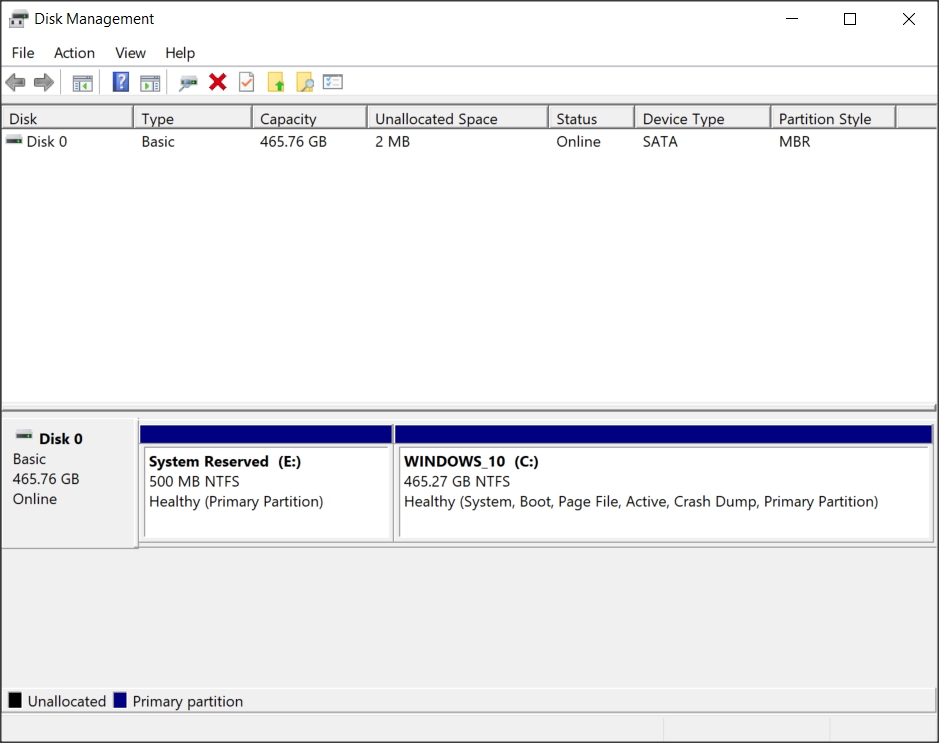

    @ The_Doman: Pic below. As ProWo said, suddenly one disk disappears. (Twilight Zone music starts here). See below, and C: is marked as boot.
    [Attachment 86899 - Click to enlarge]

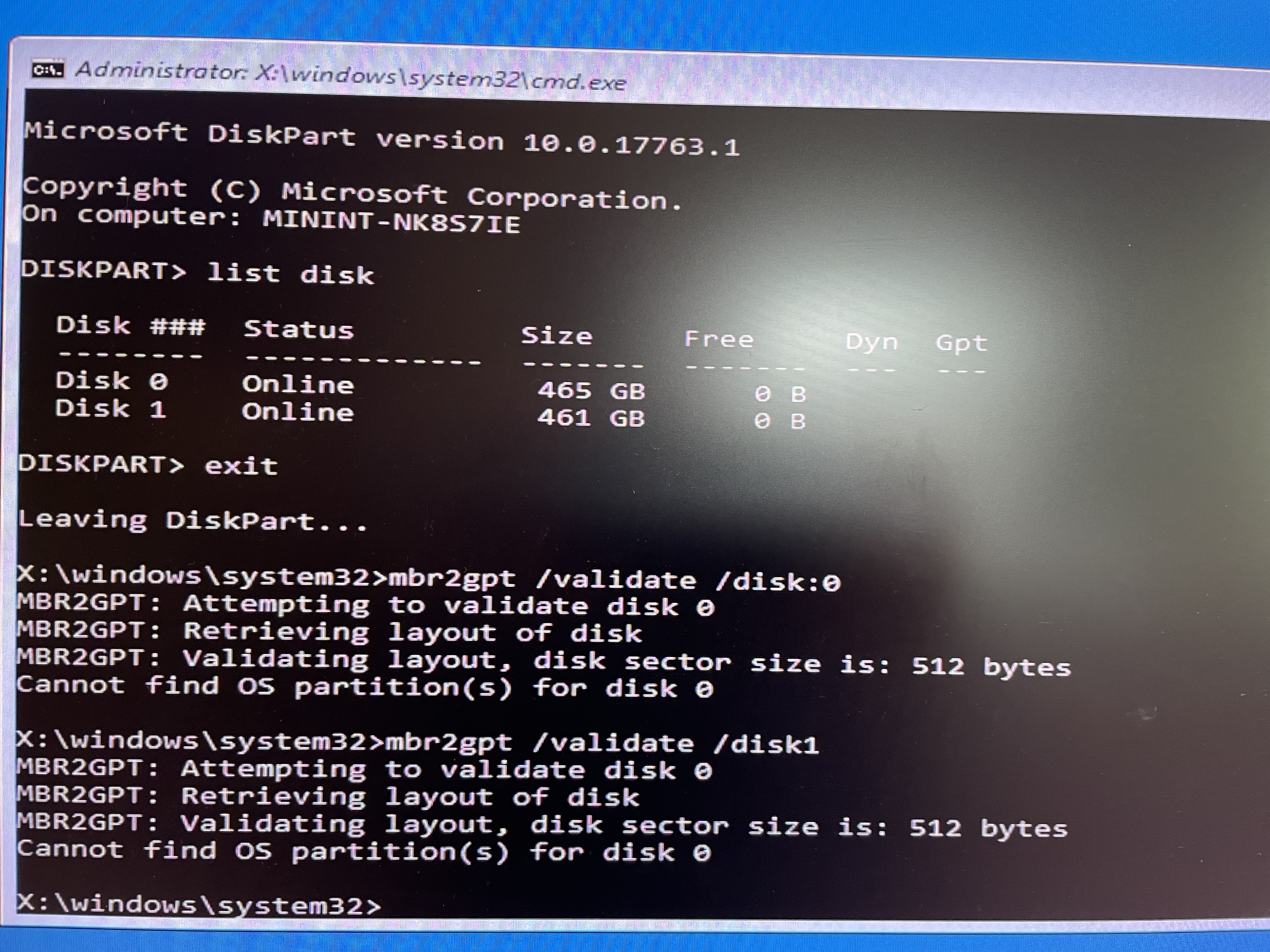

    Afterthought.....I just now booted from my thumb drive and used MBR2GPT to validate both partition 0 and partition 1, both failed.
  3. Originally Posted by ranchhand View Post
    You must use mbr2gpt on disk 0, not on the partitions.
    Type mbr2gpt /h or mbr2gpt /? for help on the exact syntax.
    Read
    https://www.windowscentral.com/how-convert-mbr-disk-gpt-move-bios-uefi-windows-10

    [Attachment 86892 - Click to enlarge]
    I noticed it only now, but the second MBR2GPT command is mistyped : after the word "disk" there's directly the drive number without the (needed) colon before.. As a matter of fact if you see the messages after the operation MBR2GPT retried to validate disk 0 again, not disk 1.
    Don't know if this could be related to your problems or not (probably not XD ), but since I noticed it I thought it was worth reporting it to you.

    Thanks Krykmoon....yes, I attempted targeting 0 as well as 1. I just keep getting the same error message, "can't find the operating system".
    and...yes I did make the ":" mistake you mentioned, and it made no difference inserting it.

    And it does not bother/concern you when suddenly you miss a complete HDD/SSD disk (and a DVD unit?) in your system?
    I would first investigate this further before you are doing any conversion operation attempts?
    Possible physically disconnect extra disks you find connected, loose wire/connectors?
    The disk management shows a basic/simple disk layout with the boot and system files on the same partition.
    This makes it possible easy to reset the BCD/boot configuration.

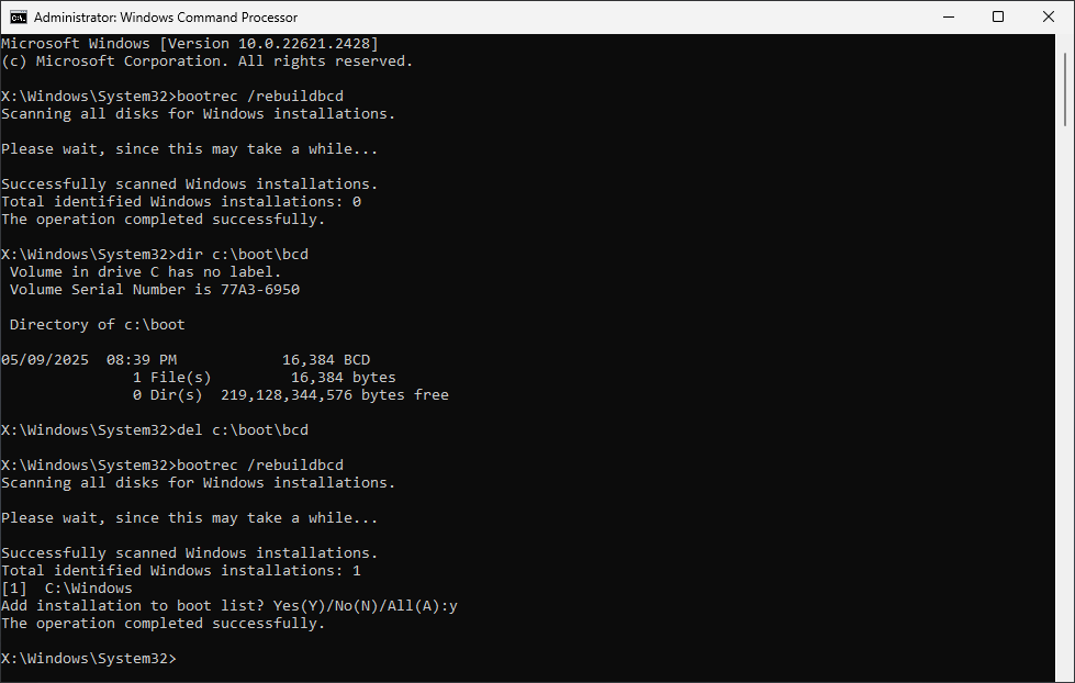

    But if you are planning to use this "nuclear" option, you also could try this following procedure to reset the boot/bcd info?
    Possible this can clean up all the problems from the MBR2GPT tool?
    Use this procedure by booting from your bootable Windows 10/11 USB, choose repair computer/troubleshoot/command prompt.
    You can also do this from the Hiren's BootCD PE
    Having a Windows USB available is always advised still, so you can try a startup repair also if needed.
    You can not do this from your live Windows system!!
    Make sure you not have any other disk connected/active which can confuse things!
    Also no guarantees or responsibility of possible data loss or unbootable system!
    This procedure will delete the current boot/BCD configuration file en rebuild it from scratch.
    This BCD file should be on your default C: drive, if not you should check other drive letters.
    You notice the first time the bootrec /rebuildbcd command does not find any Windows installations.
    Possible your situation shows different, i don't know.
    After the BCD configuration is deleted,the bootrec command should be able to find and add a new clean Windows installation entry
    bootrec /rebuildbcd
    [Attachment 86924 - Click to enlarge]
    When all is completed you should reboot and check if you still can boot the system normally.
    Then you can try the MBR2GPT again to see if it accepts the new , cleaned up, boot/configuration.

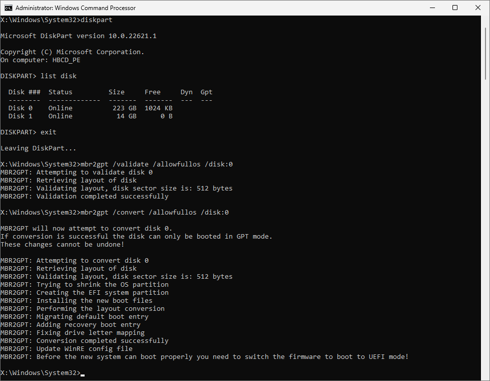

    Again, it is advised to run MBR2GPT from the Windows USB command line (troubleshoot/repair) or Hiren's BootCD PE
    MBR2GPT
    [Attachment 86925 - Click to enlarge]
