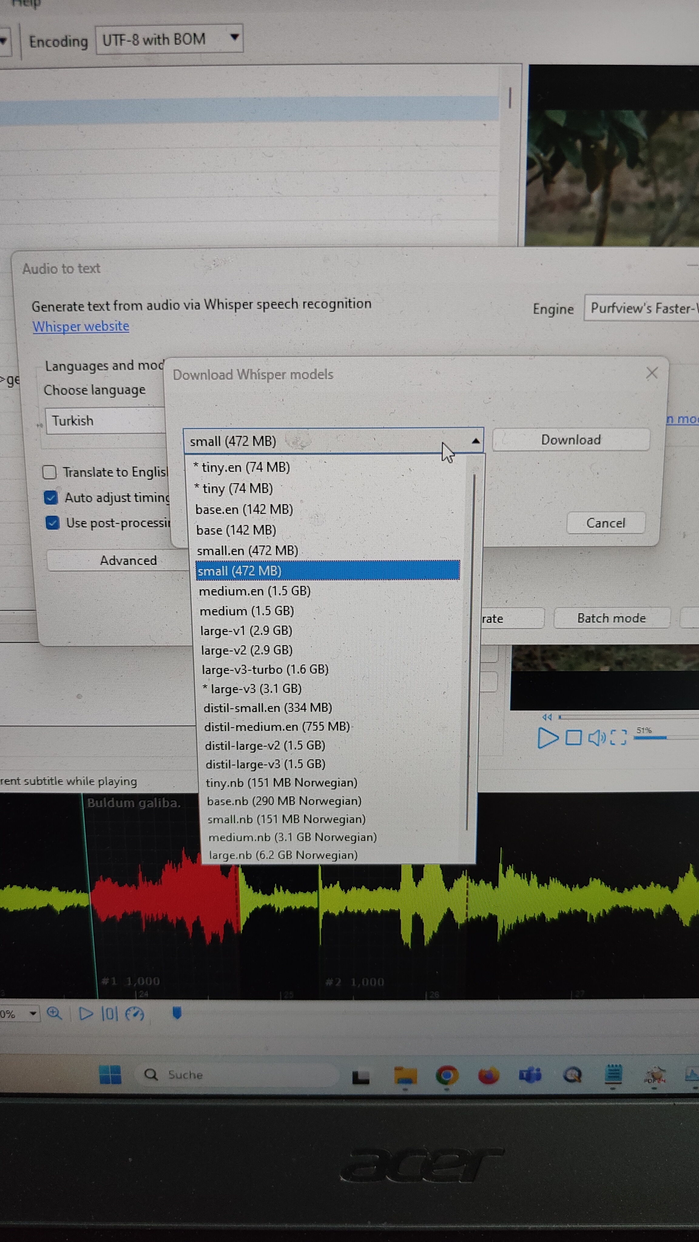

  8. So, These are the options for me.
    Language is turkish so which i should take?
    On the fly is not an Option.

    Try medium and see what happens

    4GB VRAM should be enough for large model and Faster-Whisper-XXL, but it depends from GPU model.
    Originally Posted by Subtitles View Post
    By starting too early I mean the timestamp is created at 00:00:10.000 and the actual audio starts at 00:02:20.000
    Use "--vad_method pyannote_v3", or better "--ff_vocal_extract mb-roformer --vad_method pyannote_v3" and not in SE if you drop audio files there.
