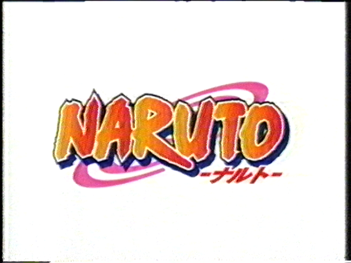

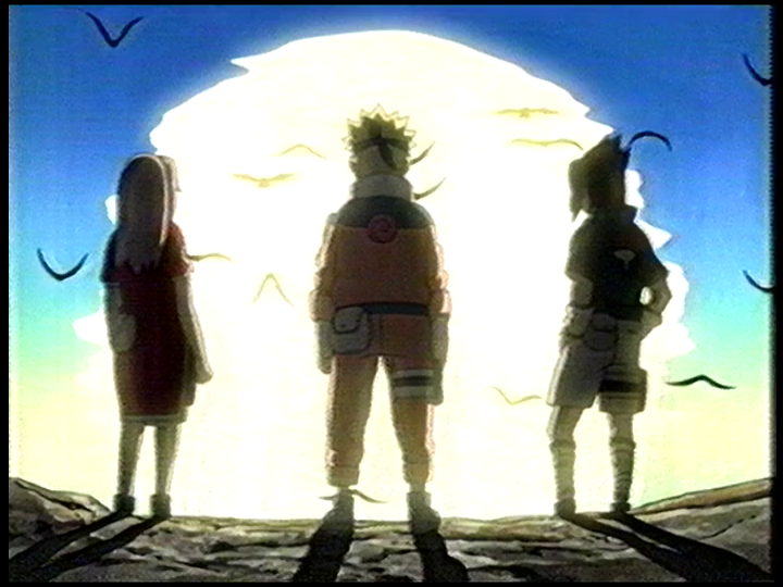

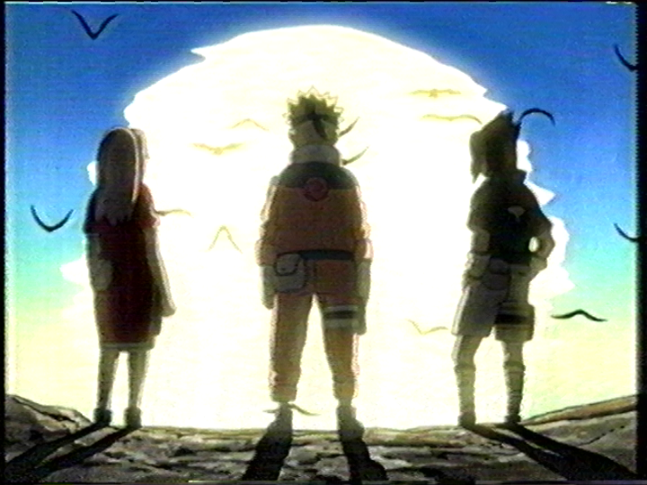

    Although it looks like nice filtering again a lot of the detail is lost (see the Gamecube logo on the console). However the color is a bit of an improvement.

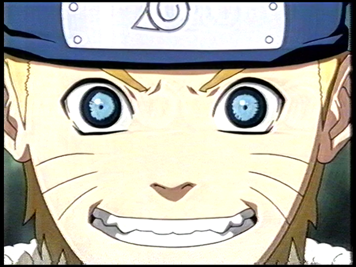

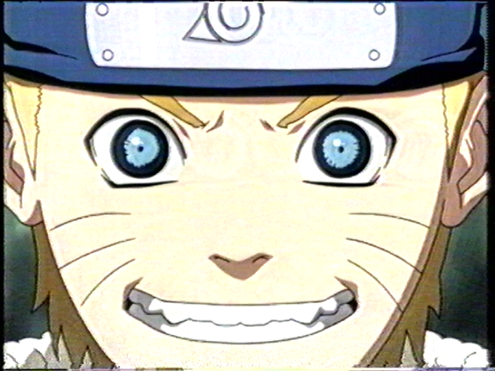

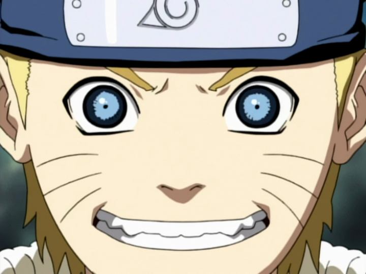

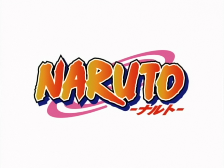

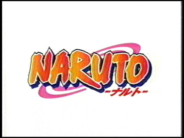

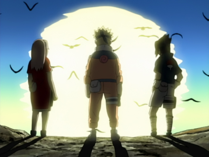

    I'm going to focus a bit more on color. See attached a comparison between Capture, Encode and DVD. The DVD provides the full frame and correct color.
    I'd like image of the encode to be more centered to match the DVD source, though due to the edge artifacts/standard garbage, I think the added black borders should remain.
    Although the DVD source has that anime stretched, more than likely correctly, I probably won't stretch the encode to match the width of the DVD. I'd need to first to have a good look at the commercials and other material to see if everything needs stretched or it's just an anime issue.
    Could you recommend a good method to correct VHS color based on a source such as DVD? See screenshot comparisons:

    Aug 2023
    GamMatch: http://avisynth.nl/index.php/GamMatch
    Some example here:
    https://forum.doom9.org/showthread.php?t=176004
    https://forum.doom9.org/showthread.php?t=173695&page=12
    https://forum.doom9.org/showthread.php?t=173695&page=13

    Yes, better crop both the source at the capture ho have “compatibile” histograms. Also better to have the two videos matching frame by frame. Insert blanks or duplicates if the capture is missing frames, then remove them later (all my captures perfectly match with a home video source, so I do not generally use this technique, just an idea).
    In my experience MatchHistogram or similar produce lower quality results compared to GamMatch, see my comparisons in the linked posts at doom9’s forums.
