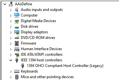

    Could be a driver issue. There are only two Firewire "drivers" for Windows, the first is default Windows 10/11 driver which is installed when you first fire up your PC with your new Firewire card in place. The second is the Legacy (original) Windows Firewire driver.
    Depending on what you have currently installed, you could try installing the other driver.
    You can see what driver Windows is currently using in the IEEE1394 section of Device Manager. If the entry doesn't have "(Legacy)" at the end of the name, you're currently on the default driver. If it does say "(Legacy)", you're on the legacy driver. Here's mine:
    [Attachment 86707 - Click to enlarge]
    I have a comprehensive explanation of the steps to follow to swap between the drivers for troubleshooting on my site here.

    Thank you for your help @Alwyn. I have tried to change to Legacy controllers, but my computer fails when doing so. I would like to try checking for the "AV gear". However, the links you provided are in localhost, therefore, I cannot access them. I would appreciate if you gave the original links to the websites.
    Hmmm, there could be a message there. I wonder if that is the cause of your trouble.
