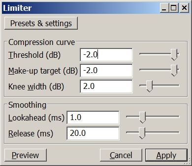

This is using Audacity 3.7.3 with the Limiter function.
[Attachment 86690 - Click to enlarge]

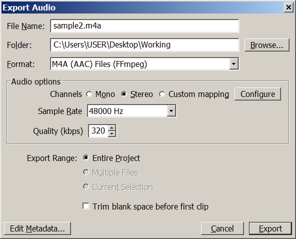

This is the Export:
[Attachment 86691 - Click to enlarge]
This removed the clipping.I had to use -2.0 as -1.5 still had some clipping.
