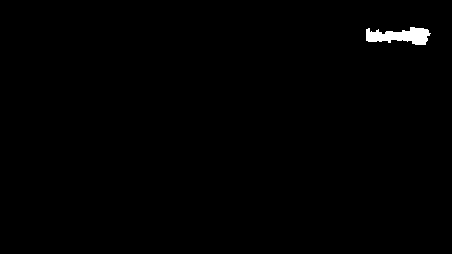

  9. Something like this:
    clip_base=ffms2("sample.mkv")  #your video
    clip_base=clip_base.AssumeTFF().QTGMC() #deinterlace
    clip_overlay=ImageSource("logo.png")  #your logo snippet
    overlay(clip_base,clip_overlay,x=1739,y=114)  #adjust x and y to fit the position exactly
    You could use a graphic tool ("magic wand") to cut a more precise part out of the logo for the overlay.
    Or you could try with Avisynth's masktools.

  11. Video Damager VoodooFX's Avatar
    Oct 2021
    At Doom9
    Originally Posted by elektro View Post
    I read about the Overlay function but it's confusing
    Use it like that:
    original_video = LWLibAvVideoSource("D:\sample.mkv")
    processed_video = original_video # pseudo code, insert your own, like QTGMC
    mask=ImageSource("D:\xxx.bmp").ConvertToY8.Trim(0,-1)
    Overlay(processed_video, original_video, mask=mask)
    How to make a logo mask out of this logo fragment?
    Use Photoshop or similar.
    You can use InpaintDelogo to get a mask, for example:
    InpaintDelogo(Loc="1540,100,-70,-876", mask="d:\xxx.bmp", Automask=1, Analyze=3)
    It should be used on your full video, after deinterlace. Here what I got from your sample (no idea if it's good):
  12. In your code snippet, is it not required to paint the areas for transparency and use the existing transparency channel from PNG?
