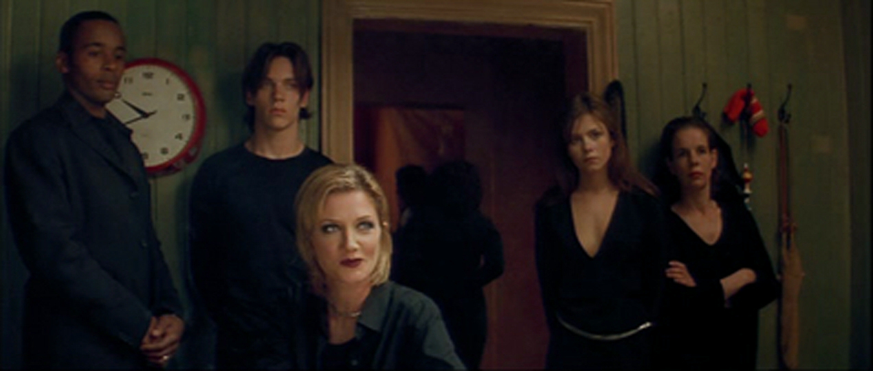

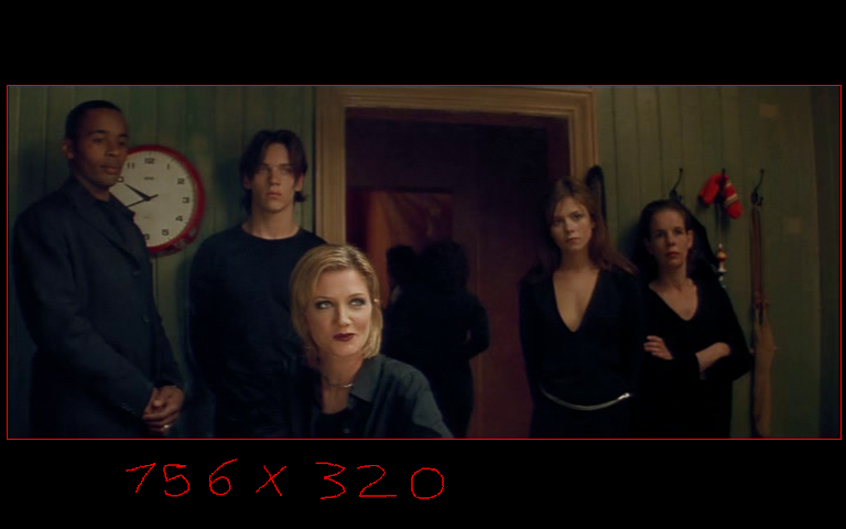

    720x480 is better. The active picture area for that is 2.2:1, although I think that even that is still too skinny. The active picture stretched out to 2.35:1 looks the most realistic to me.
    What we don't know is if they cropped a bit off the sides to make it fit better. Certainly though, the 720:540 version is definitely not right.

    And, of course, not seeing the wood for the trees, the clock gives it away!
  4. The exposed open matte on the sides leads me to believe it likely received no crops there, but that's merely an assumption, there could be other reasons it's like that.
    What I'm thinking of doing is conservatively cropping 7 left, 5 right, 78 top, 82 bottom
    which leaves a 708x320 active picture, which at PAR 1 is DAR 2.2125
    Then maybe a free resize of the vertical from 320 down to in the neighborhood of 300, just as one example, would result in DAR 2.36

    IMO, it's definitely 2.35:1 from the clock.
    I'd just crop all the black stuff off and resize to 2.35:1.
  6. With a conservative crop (grey trim and top stripe uncropped), and width resized to 752,
    I get 752x320 which exactly divides into 2.35
    Without knowing exactly how the picture was framed and conformed to the DVD,
    this is perhaps as true as I can get it while also conforming to divisibility rules of 4, 8, and 16

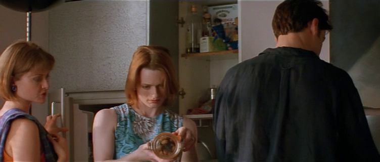

  14. Yep yep yep.
    Here's the result of an encode using 16/15 PAR correction and zealous cropping.
    I found a scene with a straight-on view of a mason jar lid... it's nearly a perfect circle.
    So now I'm fairly confident it's meant to be a letterbox display of 16:10 rather than 4:3
    (720/480)x(16/15)=1.6
    720x(16/15)=768
    768/480=1.6
