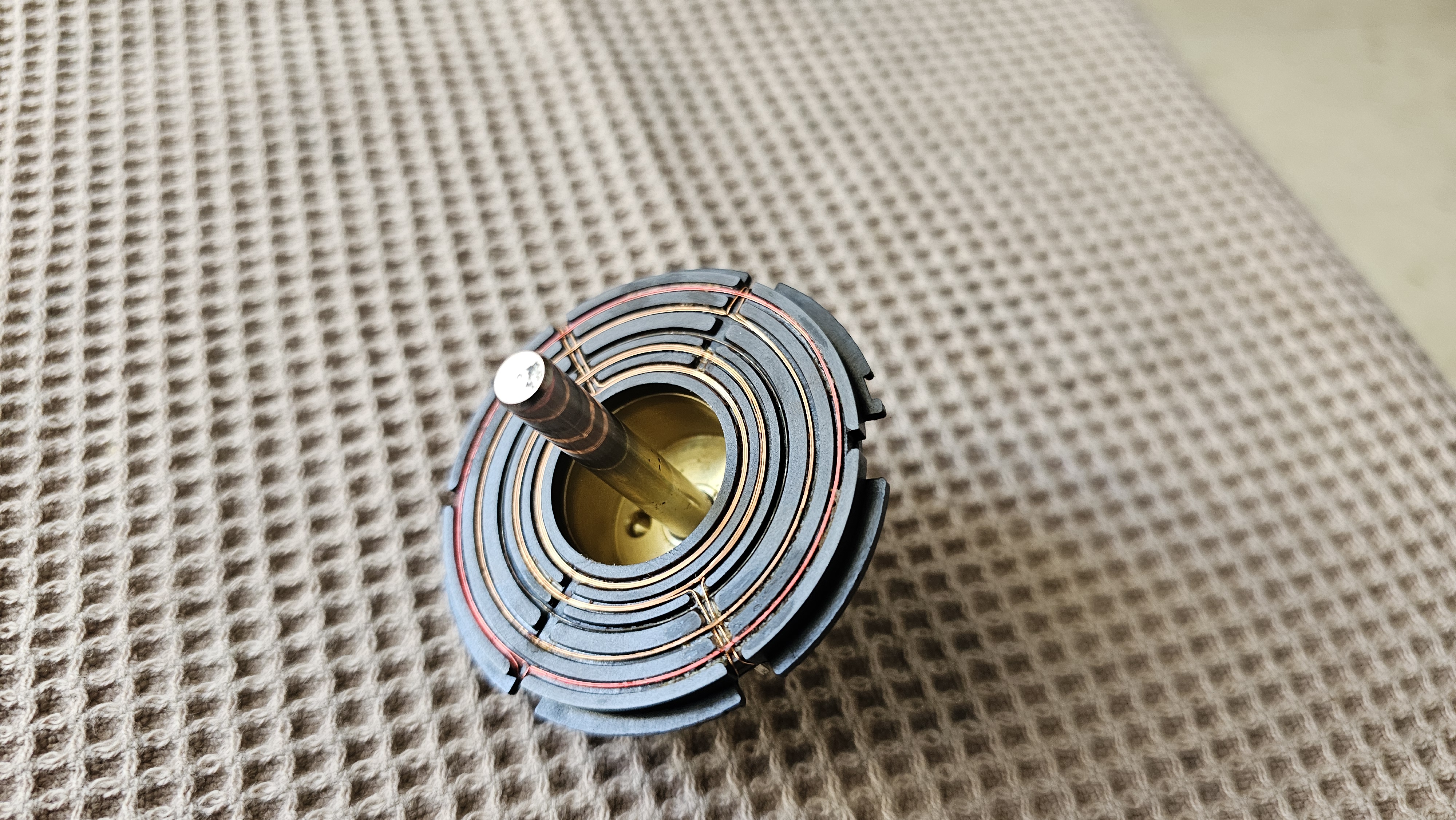

I've been running several tests and discovered that the cylinder's internal coils are loose, as if they've lost the glue that holds them to the magnet. This causes them to touch each other when rotating. I've tried gluing them together and have reduced the amount of noise, but they still touch, and some noise lines are still visible. I've also tried separating the transformers with another washer, but the separation is too large, causing the image to jump.
[Attachment 86786 - Click to enlarge]Last edited by SCART; 29th Apr 2025 at 19:24.
>Have you lubed the shaft a little ? If the drum don't speed up to its expected rpm, no wonder you get noisy pics (or nothing).
>The shaft is very darkish .
>Wires can degrade over +20 years. become fragile/crack/break
>I doubt your problem is wires touch each other (but some glue can't hurt i guess). Each set of wires is related to a specific head as far as i know.*** DIGITIZING VHS / ANALOG VIDEOS SINCE 2001**** GEAR: JVC HR-S7700MS, TOSHIBA V733EF AND MORE -
