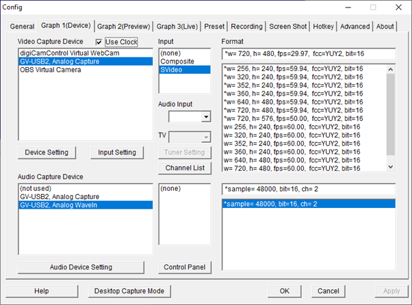

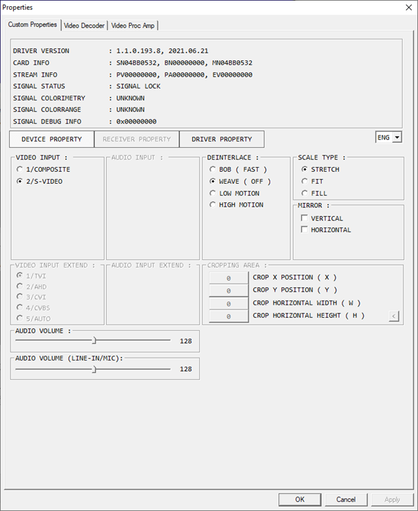

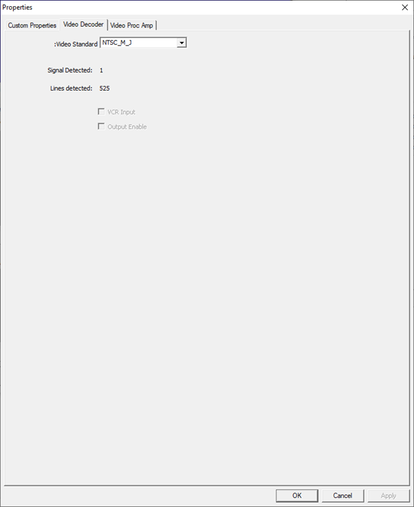

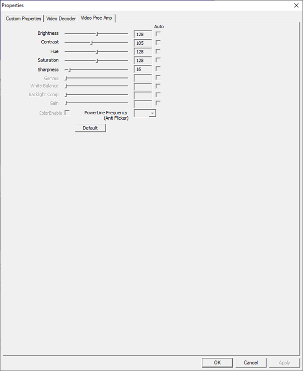

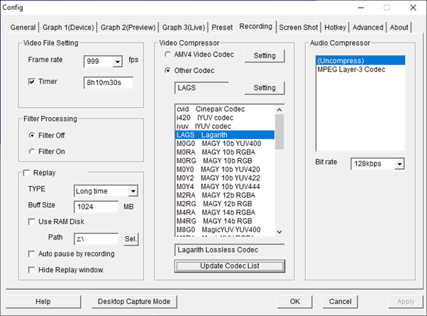

    Thanks for the very clear explanation, that puts my mind at ease. I haven't had any frame drops logged previously. I'm about to continue with my re-captures, do these settings look fine?
    [Attachment 86680 - Click to enlarge]
    [Attachment 86681 - Click to enlarge]
    [Attachment 86682 - Click to enlarge]
    [Attachment 86683 - Click to enlarge]
    [Attachment 86684 - Click to enlarge]
