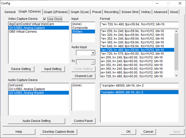

I reinstalled GV-USB2 drivers (after device issues) and now the correct frame rate option doesn't appear in Amarec, it shows 59.94 fps rather than 29.94. (All interlaced captures)

Here you go @Waxstone (my site):
https://www.aaproductions.net/gvusb2.htm
TLDR: in the Format box, just overwrite the 59.94 with 29.97. We PALites have the same issue with 50fps/25fps.
Re your captured footage at 59.94, I'm sure the experts will have a solution.
