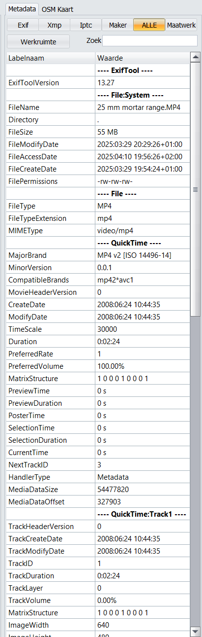

    For example I have this video file.

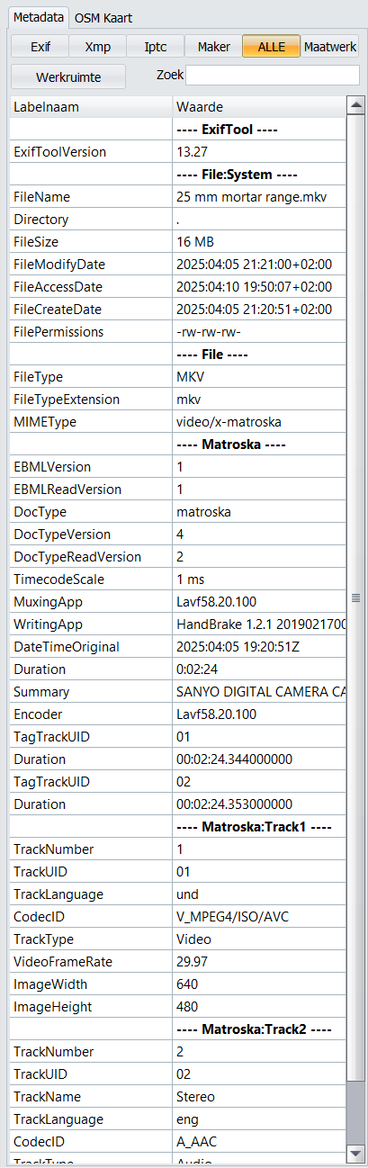

    I have converted it to this file
    [Attachment 86535 - Click to enlarge]
    I would like to change the Date Time Original field. But sadly enough I'm unable to do so. I'm ok with doing this manually if I need to. I also have minimal experience with scripting and understanding the script which ffmpeg for example use.
