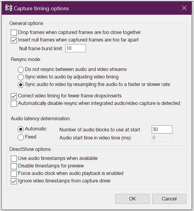

  23. Member
    Aug 2018
    Wrocław
    My last settings that worked properly.

  25. Video Restorer lordsmurf's Avatar
    If you disable either of the top two checkboxes, all that accomplishes is disabling accurate dropped/inserted frame reporting. So it "doesn't drop" because it is blind to it. "If I close my eyes, you can't see me!" or "Stop testing!" (2020). Absence of data doesn't mean absence of issue.
    Unchecking to the top box induces inserts. If inserts also not allowed (either or all, or quickly), then the outcome is audio desync.
    Those options never should have existed. It was made for a smarter era in capturing, with different hardware choices.
