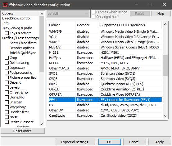

  3. Be sure you enabled both the VFW and DirectShow ffv1 decoders in ffdshow. Also make sure you installed the correct bitnes -- 32 bit for 32 bit editors, 64 bit for 64 bit editors.
  4. Originally Posted by jagabo View Post
    Yes, I have the 64bit version installed for Windows 10, and FFV1 appears to be enabled in the configuration window.

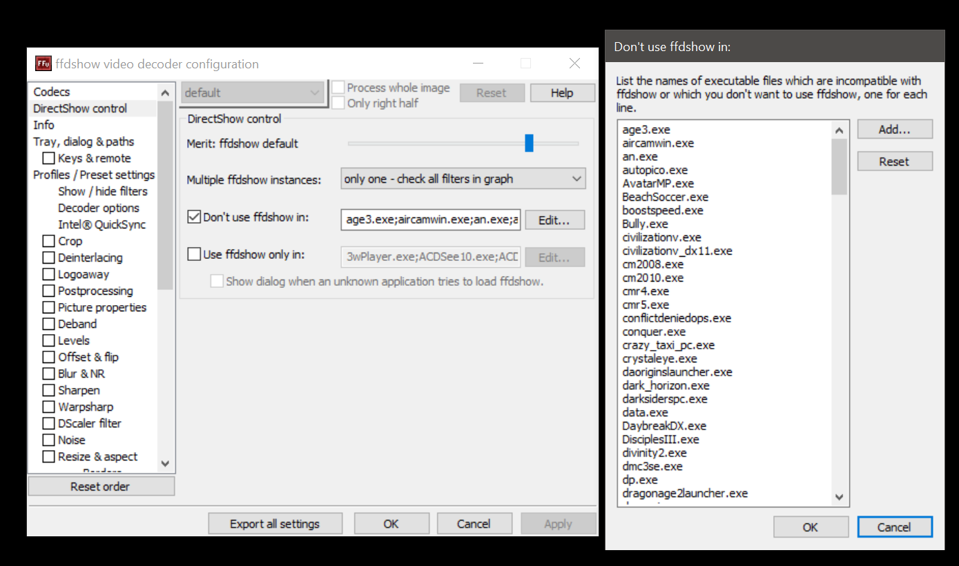

    In the DirectShow control section, it only showed options for excluding applications. I checked that After Effects is not on the list.

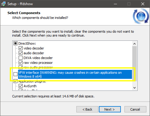

  5. You are looking at the DirectShow settings. You need the VFW (Video for Windows) section. There is another FFV1 setting there.
  6. Originally Posted by jagabo View Post
    Aha! That was it. VFW was unchecked by default when I initially installed:
    [Attachment 86502 - Click to enlarge]
    I reinstalled with VFW enabled, and the FFV1 .avi files are playing in After Effects now.
