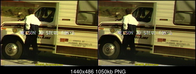

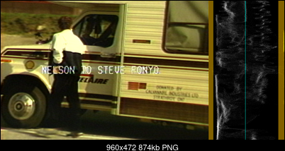

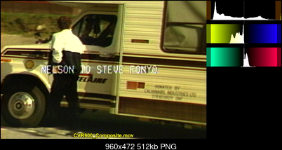

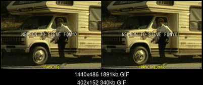

    Missed your interesting post, sorry for the late reply. Here my quick analysis.
    You are loosing details in the composite capture versus the s-video capture, because whites clipping (the shoulder of the man)

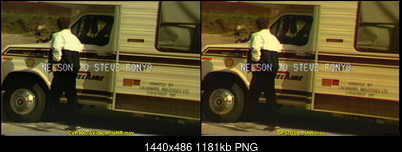

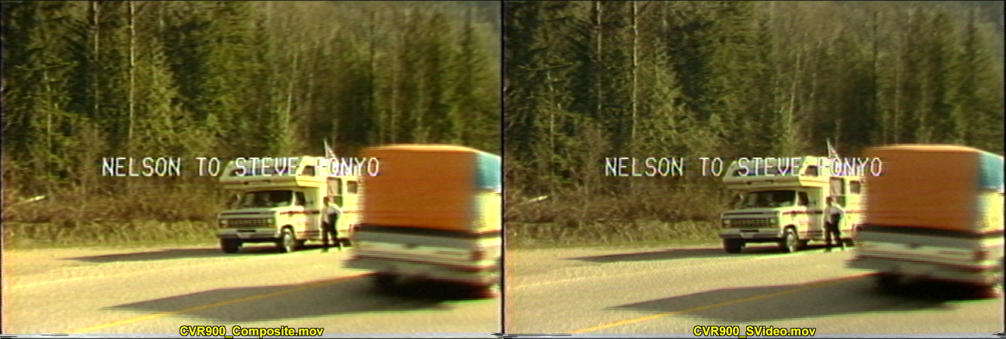

    comparison:
    with slider: https://imgsli.com/MzY1OTg0

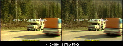

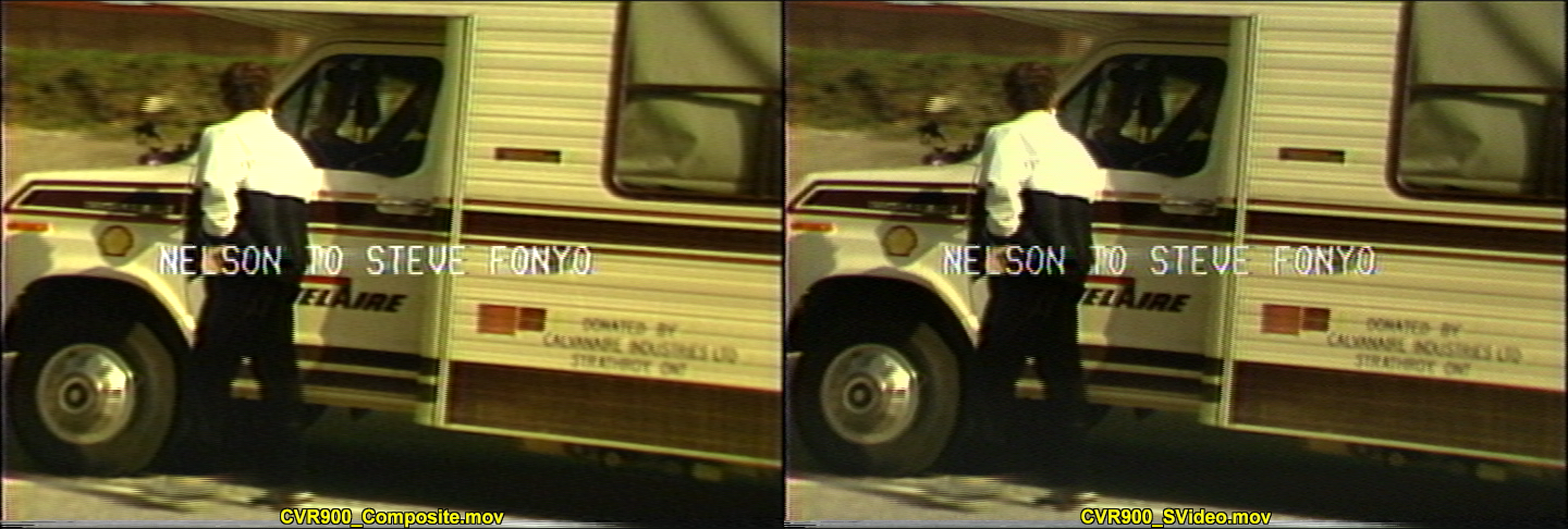

    Overall, i prefer s-video capture because sharpness and colors:
    comparison:
    with slider: https://imgsli.com/MzY1OTg4

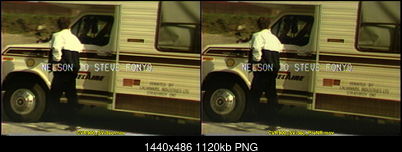

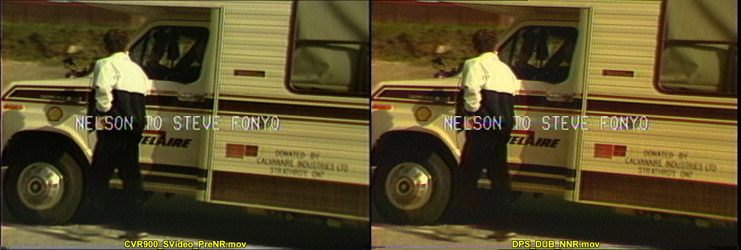

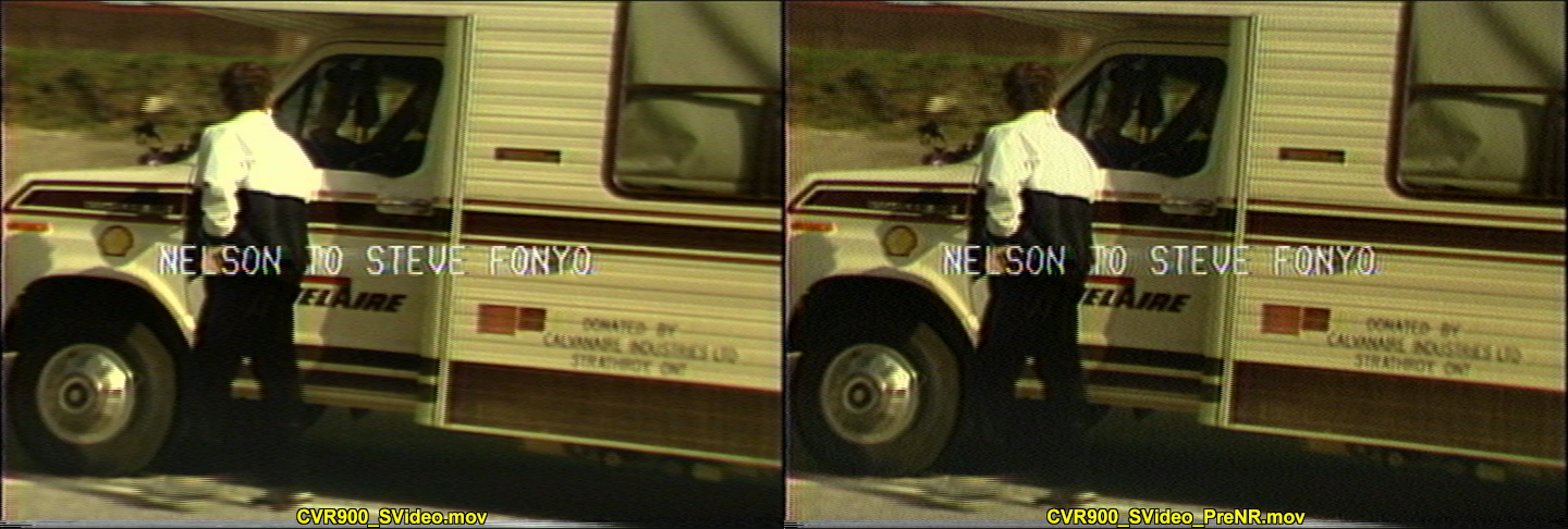

    Comparing SVideo versus SVideo_PreNR is more difficult. I think the second is more detailed while having more noise (the vertical pattern in the middle of the van (assuming is not an artifact), the logo in the front of the van, etc.):
    with slider: https://imgsli.com/MzY1OTkw
    If a restoration with AviSynth is planned, this capture is a better candidate, because we can soften the noise while (hopefully) mantain the higher number of details present compared to the SVideo capture.
    Introducing now the 4th capture (DPS_DUB_NNR.mov) the bad colors do not allow directly a fair comparison, and the image is loosing a portion of the image (left shift by 4 pixels); in addition, there is a distortion of the top of the picture, clockwise.
    Reducing a little bit the saturation and the V channel to equalize and compare, at first impression I prefer the CVR900_SVideo_PreNR capture:

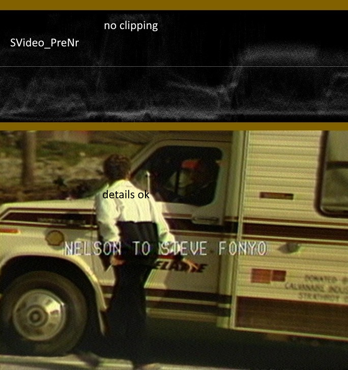

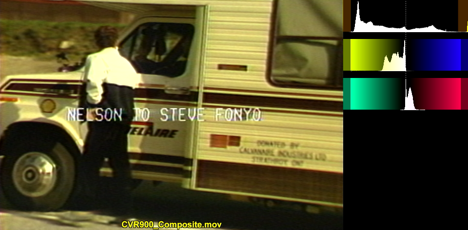

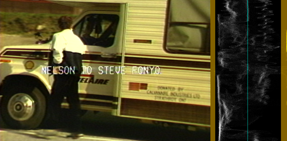

  3. Using the waveform monitor:
    Apart from the noise I would prefer the CVR900_SVideo_PreNR because it is the only one which does neither crush nor clip the brights
    - The CVR900_Composite produces out of gamut RGB and clipping at Y=255, loosing all details in the brights
    - The CVR900_SVideo is within Y(16....235) but still clips/crushes the brights at Y=209 and is therefore still loosing details in the brights
    Edit: All 3 with chroma ghosts
    (DUB and Elgato are out)

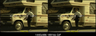

    Minimum processing and deringing on capture CVR900_SVideo.mov to upscale for youtube:
    QTGMC(preset="slow", matchpreset="slow", matchpreset2="slow", sourcematch=3, tr1=2, tr2=0, NoiseTR=2, sharpness=0.1)
    dering(A=0.3, W=3.5, RelVisibleTh=0.01, AbsVisibleTh=0.005, PostFilter="median2", PreFilter="FIR2", SkipAlonePeaks=true)
    TemporalDegrain2(degrainTR=1)
    LSFmod(defaults="slow")
    nnedi3_rpow2(rfactor=2, nns=4, qual=2, cshift="Spline36Resize", fwidth=1440, fheight=1080)
    deringing effect: https://imgsli.com/MzY2MTk3
    org vs restored: https://imgsli.com/MzY2MTk4
    ouuput: https://www.youtube.com/watch?v=GQMVtFD0s5g (uploaded to my channel because large size, then compressed by YT)
    This was just a quick attempt, try to experiment changing the parameters of the filters.

Name:	Nuovo AviSynth Script.gif
