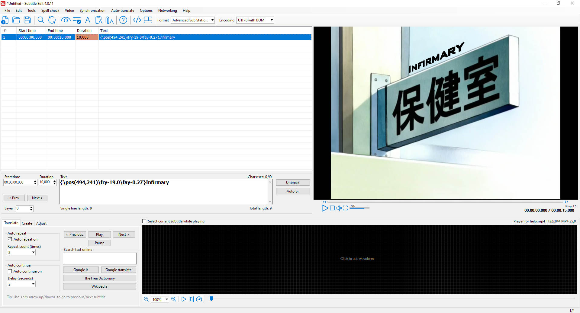

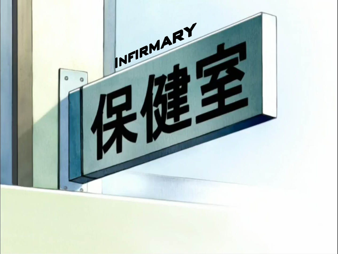

    Anyone here that can help explain how I can produce translations on signs (in this case from kanji to latin alphabet in anime) with correct "angles"? Hard to explain but I can never get the translated text to match the up-right trajectory of the in-anime sign, check uploaded picture. I can use {\fr}, {\fry} or {\frx} but they never seem to become straight-up standing text - only skewed and slanted degrees, when I try to fix it. 3D view point/anchor point seem to be an issue here. A "z" factor is missing, maybe.
    The image shows my problem - "my" infirmary is just slanted to match some angles, but I need the text to stand straight up as well, just like the original sign text, not just slant inwards, like in my pic! "My" infirmary needs to be leaned back.
    I fear I'm hopeless at explaining my point; I hope someone get what I want to convey here.
    [Attachment 86348 - Click to enlarge]
    Praise you if you can help me.

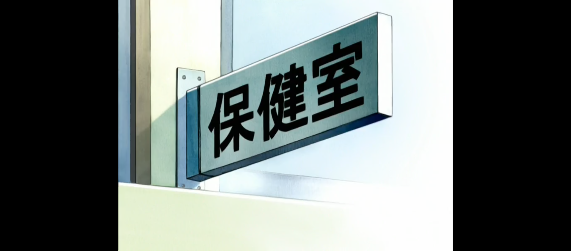

    I've tried to find information about SE + "\org", but that opened another question; where, exactly, is the anchor point? Which corner of the word or sentence is anchor, there are four and it can't be all of them, I'm guessing. There is just too little info, just a few, not-so-informative lines on www.nikse.dk and I'm a bit frustrated. With the little information I got, I tried to "upright" my "infirmary" with the help of \org, but I had no luck, maybe because of not understanding anchor points.
    Krykmoon, you said you done some tests. I've uploaded the complete picture of kanji sing "infirmary" - would you give it a try and see if you can get the text the way I intend it to be? I just can't get it to work. I'd also need the "code" or full sentence from SE (don't know what to call it) so I can understand what is required of me to do.
    If you don't want to give it a try, thank you anyway.
    [Attachment 86365 - Click to enlarge]

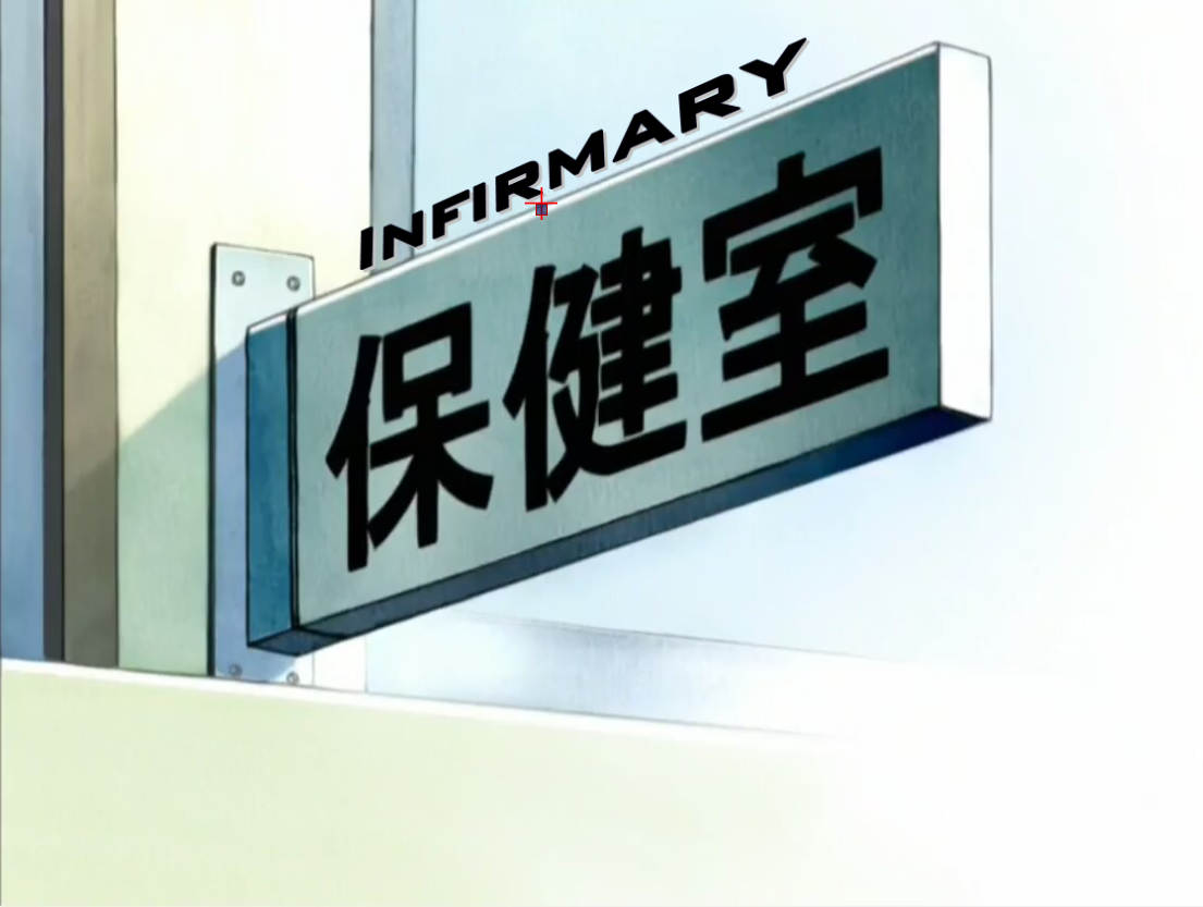

    You were trying to do something like this ?
    A couple of minutes tampering with Kainote positioning tools.. with more effort you can do even better (the perspective alignment is not very precise).

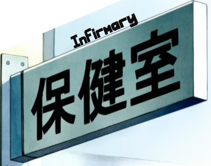

    It was many years since the last time I used Subtitle Edit... but I downloaded it and tried to do the same.
    Yes, it's not to difficult to achieve (quite) the same result.

    That is very interesting. I didn't recognize that negative numbers (-19, -0.27) were even used. I never saw "\fay" before but found it on nikse.dk under something called "text shearing". Now I have \org and \fay that I never knew of, and negative numbers.
    Your picture looks great, letters standing upright, but when I took your "code" and pasted it into my SE... not the same results as your pic. My "infirmary" is still slanting inwards, and doesn't align with straight up trajectory. You also didn't use \fr, which I have too, or it's way of mark. I don't understand why there is a difference and since anime contains plenty of signs like "infirmary", it feels important for me to grasp. But I don't. Possibly my dyscalculia prevents me for "getting it" but I don't like to give up. For me to lean my "infirmary" backwards to uptight position, which do I need to tinker with; -19 or -0.27? I tried both, both up and down, but to no satisfaction. They influence each other, maybe? And how does \org and/or anchor point play a part here? You mentioned that I had to change perspective, and I get that, but how is that done? As a person with dyscalculia, I grasp these concepts intellectually but I can't execute them. I apologize that I seem dense in this, not much I can do about it.
    Thanks for all your help so far.
    UPDATE: I think I solved it! I tried to use {\fax-0.1} - thanks to you opening my eyes to {\fay} and negative numbers - and it looks as beautiful as your pics! At least to those two signs I tried. Wow... I had this problem for years.
