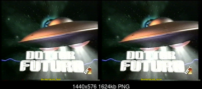

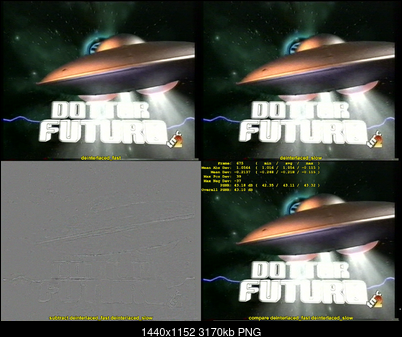

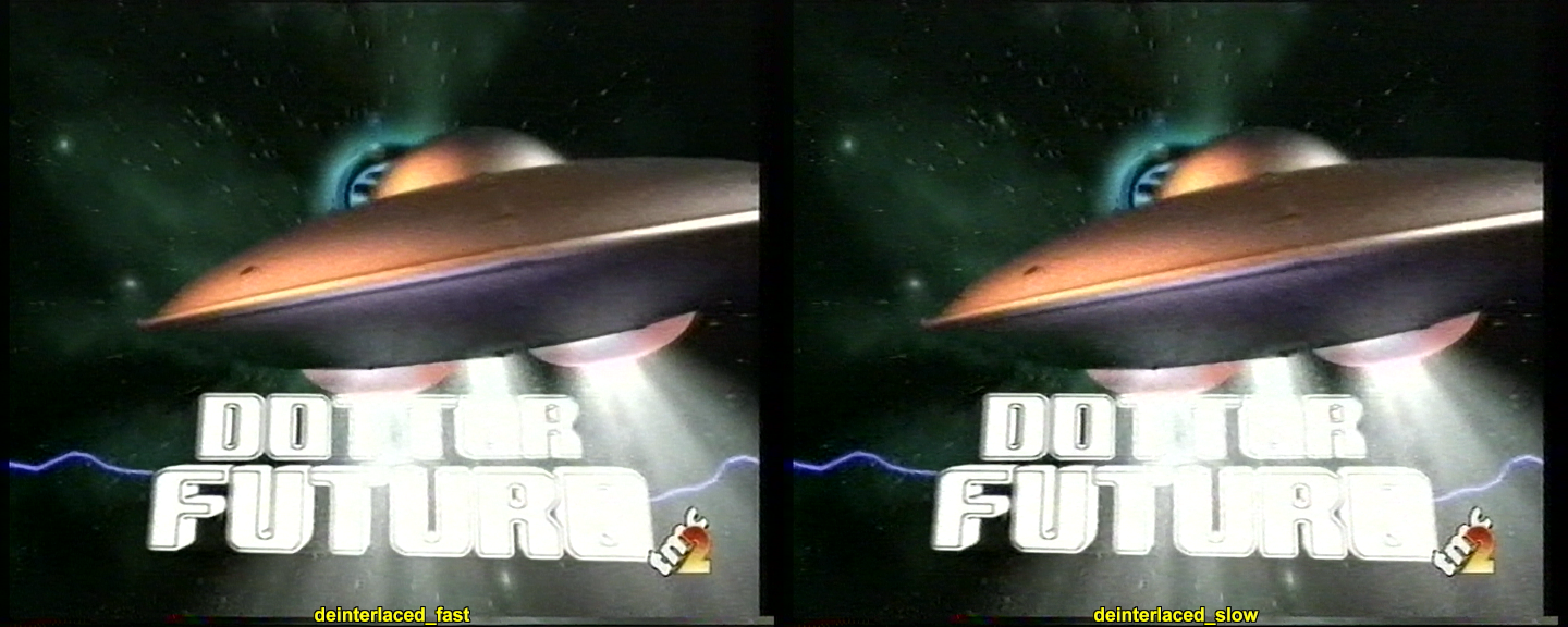

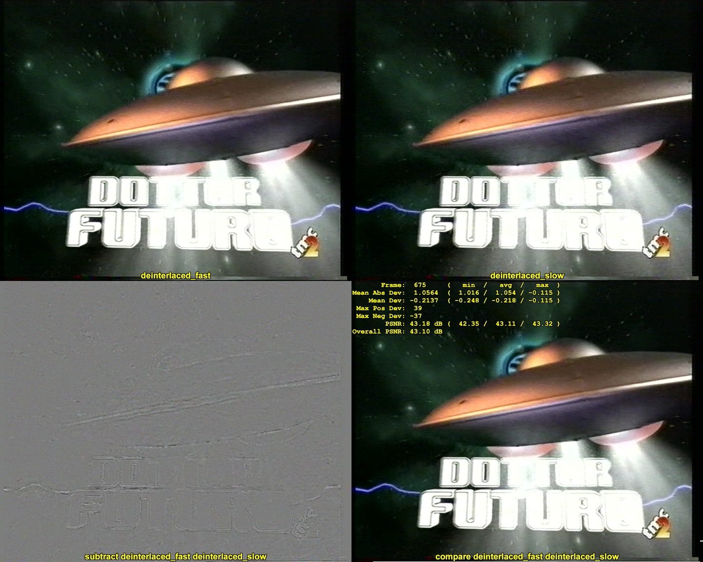

    Here an example, just the first I have, maybe not particularly significant using
    QTGMC(preset="fast")
    versus
    QTGMC(preset="slow", matchpreset="slow", matchpreset2="slow", sourcematch=3, tr1=2, tr2=0, NoiseTR=2, sharpness=0.1)
    comparison with slider: https://slow.pics/s/8Rj7fhn6

    Originally Posted by clashradio View Post
    I've reading some contrary info at digitalFAQ.
    Have you ever seen any comparison there?
    cbehr91 says "Slower", which is major overkill most of the time. Your video will look overly smooth and plastic-y. Try fast/faster in conjunction with tweaking SourceMatch and Lossless".
    We all try to reduce the denoise/smoothing of QTGMC to minimum possible, to use better processing later. But is not easy.
    Once more, as Sharc already said, for optimal results experiment with your source and do not trust blind suggestions!
  29. Originally Posted by lollo View Post
    Originally Posted by salvo00786 View Post
    All my deinterlaced files go to denoise with Nyx or to upscale. I don't know if for Nyx is better a Lossless=1 file or a Lossless=2 file
    As Sharc said, the lossless options in QTGMC aims to keep the original fields, and are then producing less overall quality.
    It is used just when you deinterlace-process-discharge.the.additional.frames-interlace.back
    Lollo, if I understood correctly, it's better to delete lossless for maximum quality? and for maximum details it's better to use lossless or not? and Sourcematch?
  30. Captures & Restoration lollo's Avatar
    Jul 2018
    Italy
    Yes. QTGMC goal is to deinterlace, and it performs better when it does not have to keep the orginal field.
    About maximum details the same applies; however, here you do not have to refer to the original field as comparison, but the rebuilt frames in their integrity. In other words, QTGMC builds 2 frames from the interlaced fields, so the only appropriate comparison is between deinterlaced frames obtained with different options. And there you can check what is more performing, also taking into account the quality of the moving objects/parts.
    In term of "details versus the original" the concept is the "smoothness" of the outcomes, and here master poisondeathray already addressed versus a parameter choice reducing this action to preserve more elements.
    Is not easy to give a general rule, the source really plays a role here. And QTGMC is a complex function!
