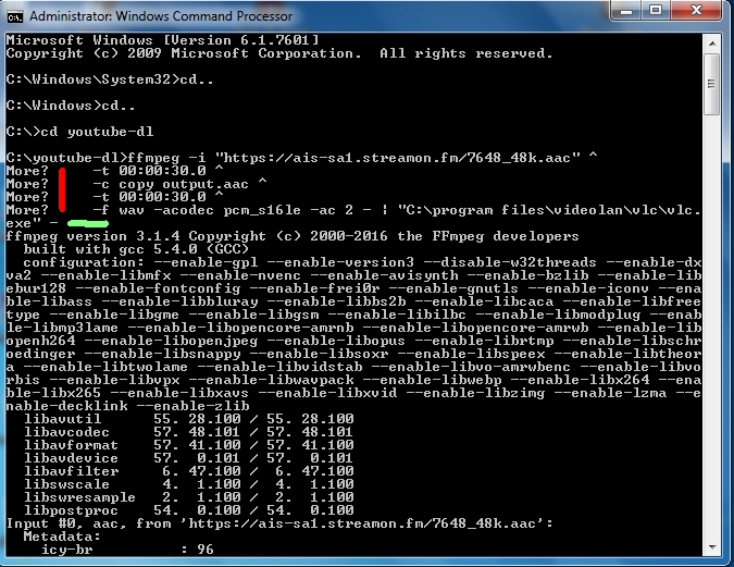

    I do have a question. In the command output, what does the "more' mean (shown four times with red mark)? Also, why do I have to press enter to continue at that point (shown with green mark)?

  4. The CLI just telling you it's ready for more input since the previous line ended with a ^. I ran it from a batch file so all the lines were simply concatenated before being executed:
    ffmpeg -i "https://ais-sa1.streamon.fm/7648_48k.aac"     -t 00:00:10.0     -c copy output.aac     -t 00:00:10.0     -f wav -acodec pcm_s16le -ac 2 -   | "G:\program files\videolan\vlc\vlc.exe" -
