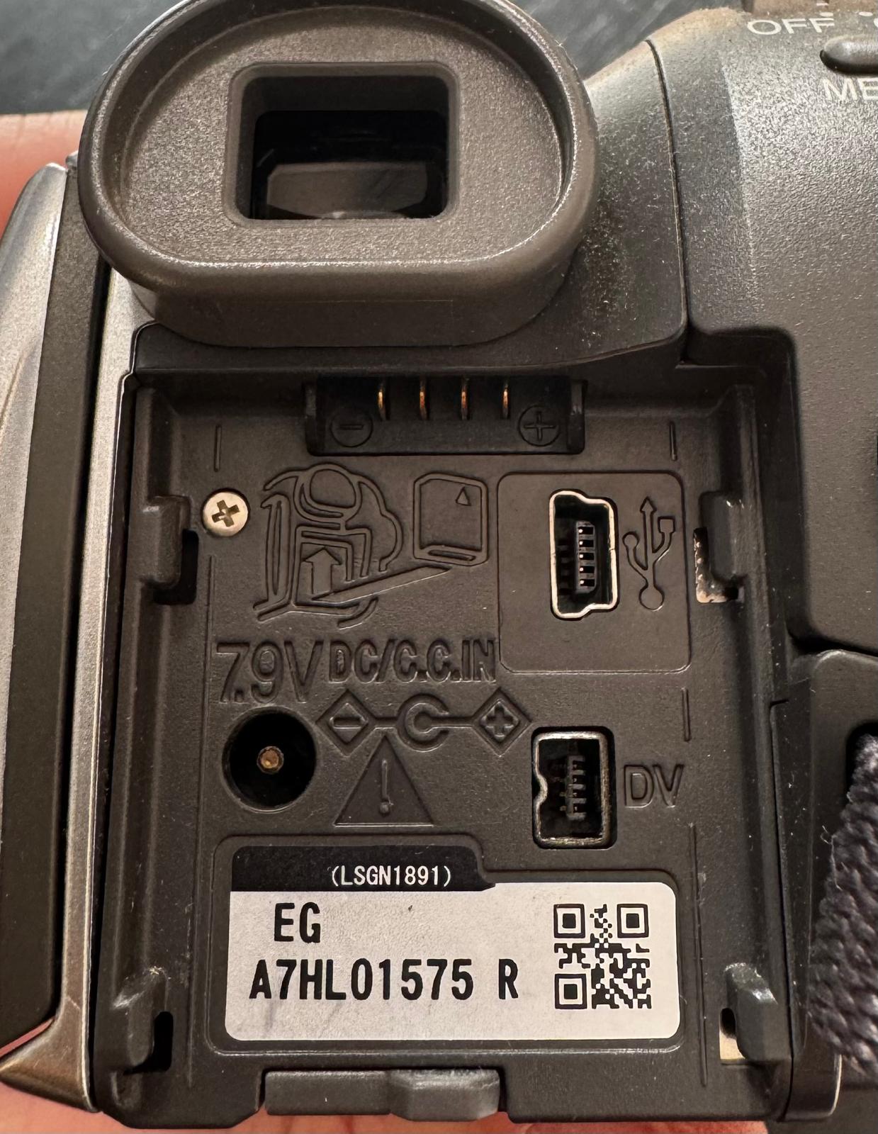

    The port on my video-camera is miniDV, I think.
    [Attachment 86292 - Click to enlarge]

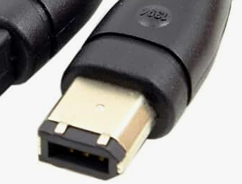

    I seem to remember I used to transfer it via a miniDV - FW400 cable via my Windows Desktop Pinnacle PCI card, long disposed of.
    [Attachment 86293 - Click to enlarge]
    Perhaps my best option would be a DV transfer device, perhaps via USB C or Thunderbolt, if that even exists?
    Your camcorder supports DV over USB (USB Motion DV option), so the easiest option is to try that first?
    You only need a mini USB cable.
    Scenalyzerlive should work capturing over USB.
    @Wills, definitely try that USB socket with a USB cable (full size USB-A on one end, USB Mini B on the other), as The Doman suggests. If that doesn't work, there are other, less-friendly options.
