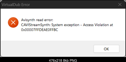

    i'm trying to encode one of my tape transfers via an avisynth script through ffmpeg. for some reason the process is stopping randomly in the middle of the encode with no error message. i loaded the script up in virtualdub and tried an encode, but i get this error after a while:
    is there a fix? my source files are ffv1+flac. i'm running 64-bit avisynth+ 3.7.3 r4003

    i also tried a fast recompress to magicyuv in virtualdub, and i got the access violation error mentioned above.
