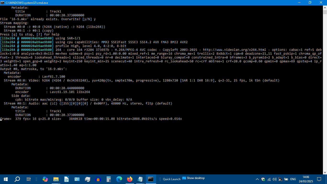

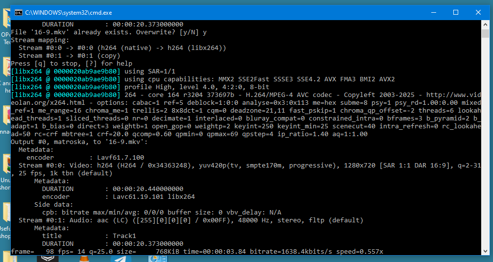

    Sharc, I'm sorry but I spoke too quickly when I said the command line to add the bars "worked". The file that you posted to me named "16-9.mkv" does display unstretched on my TV with black bars as it should but although the command ran in the black boxand appeared to be doing something for about as long as it takes to play the ectual file, the end result file appeared unchanged and didn't display black bars on the TV.
    Attached some screenshots of the process.
    FWIW the process doesn't seem to create a copy of the file, I'm left with the same file except than in properties the creation time is updated to the time the command was run. Which I suppose is what I should expect.
