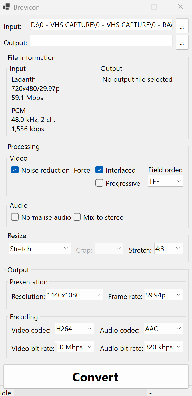

I've captured lots of raw Japanese broadcast tapes and have found a simple but effective tool called Brovicon, which converts the video into (mainly) everything I need. However it's still a bit buggy, and because it's a GUI for avisynth it's quite slow when compared to other tools out there. This is the general setup:
[Attachment 86010 - Click to enlarge]

This is what I'm trying to achieve, similar to Brovicon:
Noise reduction
Crop the dud regions and dot crawl
Add Borders to maintain 720x576
29.97fps -> 59.94fps, QTGMC deinterlace "fast" TFF
720 x 480p -> 1440 x 1080p (whatever scaling method works best for YouTube)
h264 at -crf 18, aac at 320kbps, .mp4 container
Please see sample video attached.
