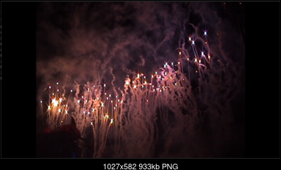

    What I was asking for help with is this:
    Is to create a 16:9 sd blu ray that the original video stays intact, but when playing it, it creates these black vertical bars to fill in the 16:9, since the original video is 4:3. Here is an image of the sd blu ray that creates TMPG (I had to set in properties picture ratio to 16:9 in the software)
    Jan 2016
    No need to, if you flag it correctly for 4:3 aspect ratio it will leave black pillars on the sides during playback automatically, Hard coding black bands in videos is never a good idea.
    Nov 2023
    Santiago
    That's what I wanted to know, if I leave it in 4:3 is like playing the AVI video directly but in Blu ray format, the ideal was also play it in 16:9 for smartv screens.
