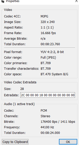

    first post.... I have an old AVI (MPG) that should have audio.... VirtualDub says there is Audio... DivFix++ says there are errors it cannot fix.
    I would REALLY like a fix for this as it is a video of my daughter's very first singing concert (5 yo). I am wondering about a couple of things;
    Are there actual errors in the file and if so how do I repair them.... the video is grainy but fine.. it's just the audio
    or
    Is it a matter of the PC trying to play an AVI file when it is an old mpg file?
    Obviously, I'm not the expert. But maybe someone here is.
    Many thanks
    Peter

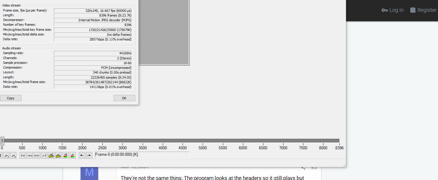

  2. additional
Name:	lize info 2.jpg
