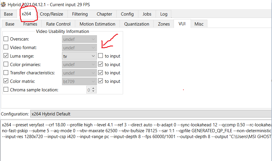

  1. I'm having trouble converting the fps of a video with Vapoursynth support in Hybrid version 2021.04.12.1.
    It turns out that I need to manually change the color space, which is automatically set to ''pc'' in the software, and if I don't change it to ''tv'', the colors in my post-processed video become darker and have stronger contrast. The problem is that I can't find this option to change the ''Luma range'' to the lossless ''ProRes'' codec, because in x264 the video is quite compressed.
    I tried to change some options in the VUI but the video still has the colors changed
    Does anyone have a solution for this? Below are some photos

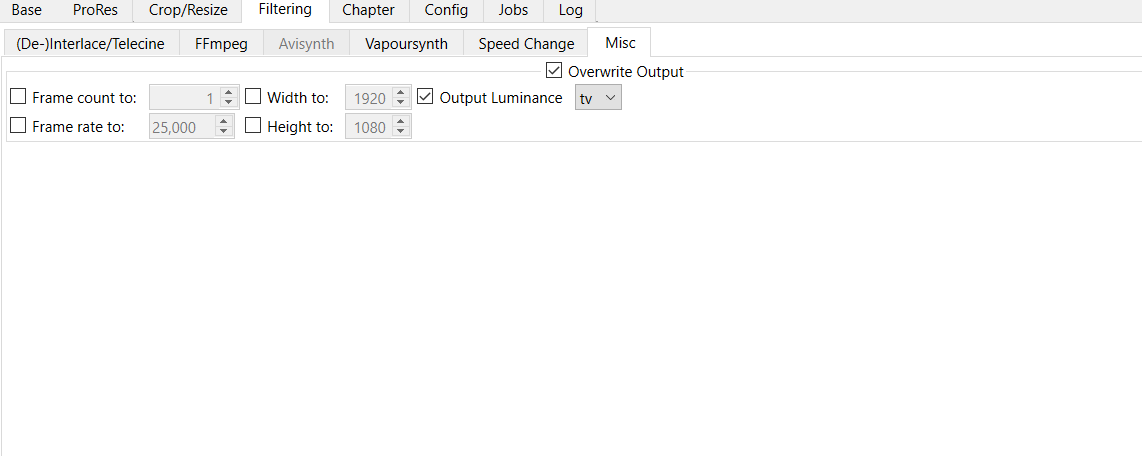

  2. When your input luminance is wrongly flagged in the source, you should use "Filtering->Misc->Overwrite Input->Overwrite input luminance".
    Cu Selur
  3. Originally Posted by Selur View Post
    Cu Selur
    I don't understand, I make the change this way, but the video continues with the same different color after processing
