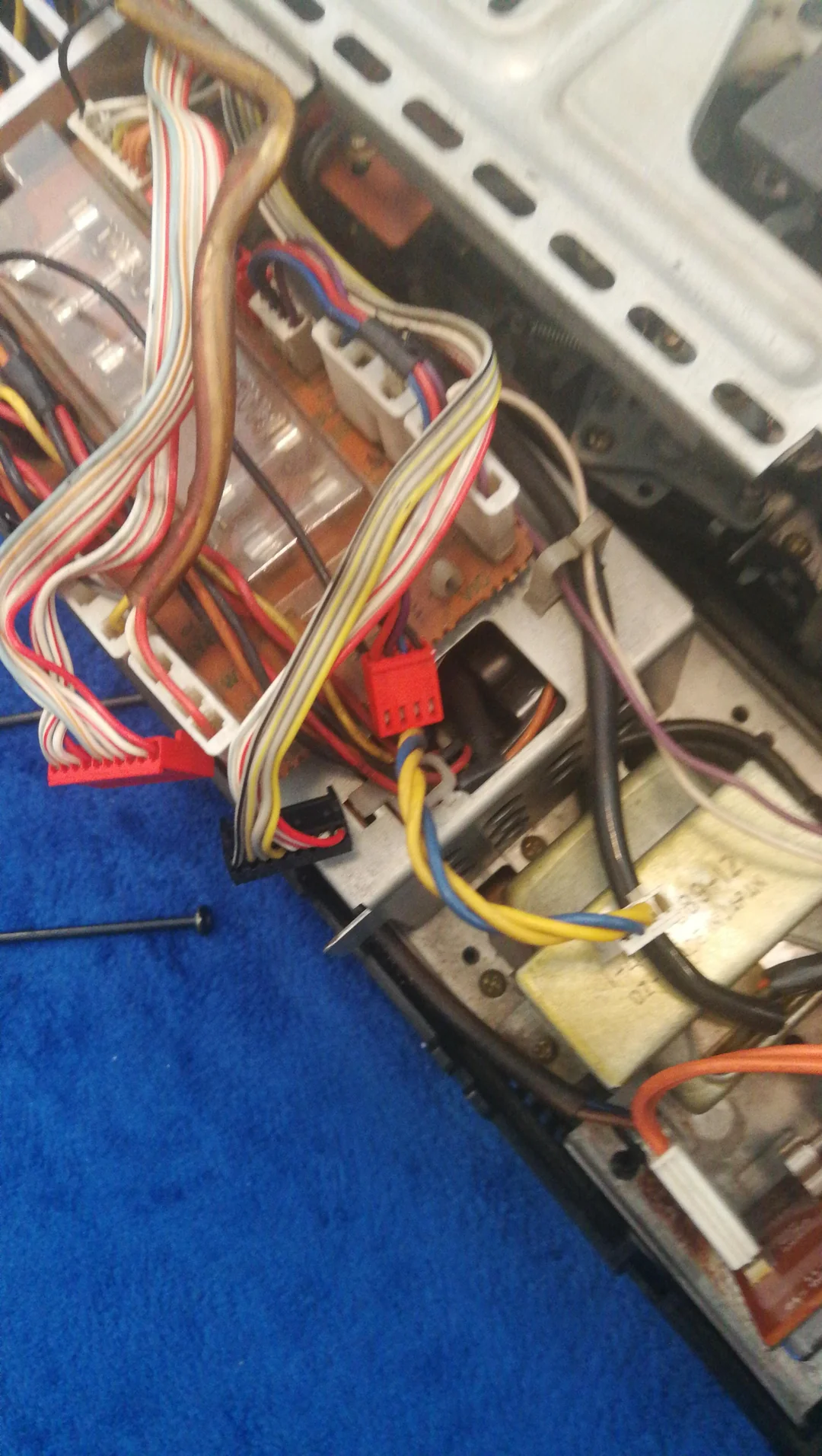

  1. So i have a Sony Betamax SL-C7E that has a broken timer block(it contains boards TM-10, TM-11 and TM-12). Is there a way to bypass it?
    Image of the cables, and the connections to the boards i found in the manual.
    [Attachment 85919 - Click to enlarge]

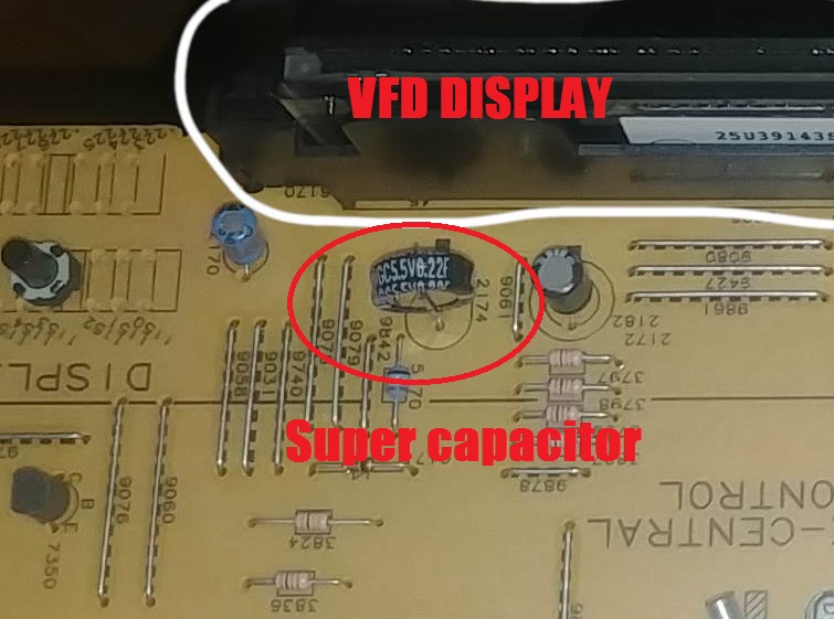

  2. I don't know much about betamax but on vhs deck (philips and others) the timer chip is linked to a super capacitor. You change it you restore the timer (small and round)

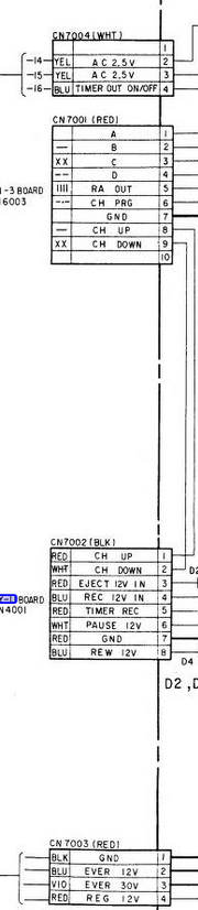

    Try linking the 'blu' wire on CN7004 to the chassis. If that doesn't work, get hold of a 1K Ohm resistor and use it (with extension wires if needed) between that blue wire and the blue wire on CN7003. That will mimic the timer output signal as low or high level, I have no idea which is on and which is off. It is possible other functions are on the timer board that are necessary for normal operations. Only one way to find out....

  10. I suggested the 1K resistor because it would offer some protection, not knowing what the signal fed in to. Now I have seen the schematic I think it is safe to directly link it to CN7003 as long as the timer board is not present. The signal feeds the power supply and seems to be a simple "turn on/turn off" control. It is a combination of the manual power switch and the timer output.
    Brian.
