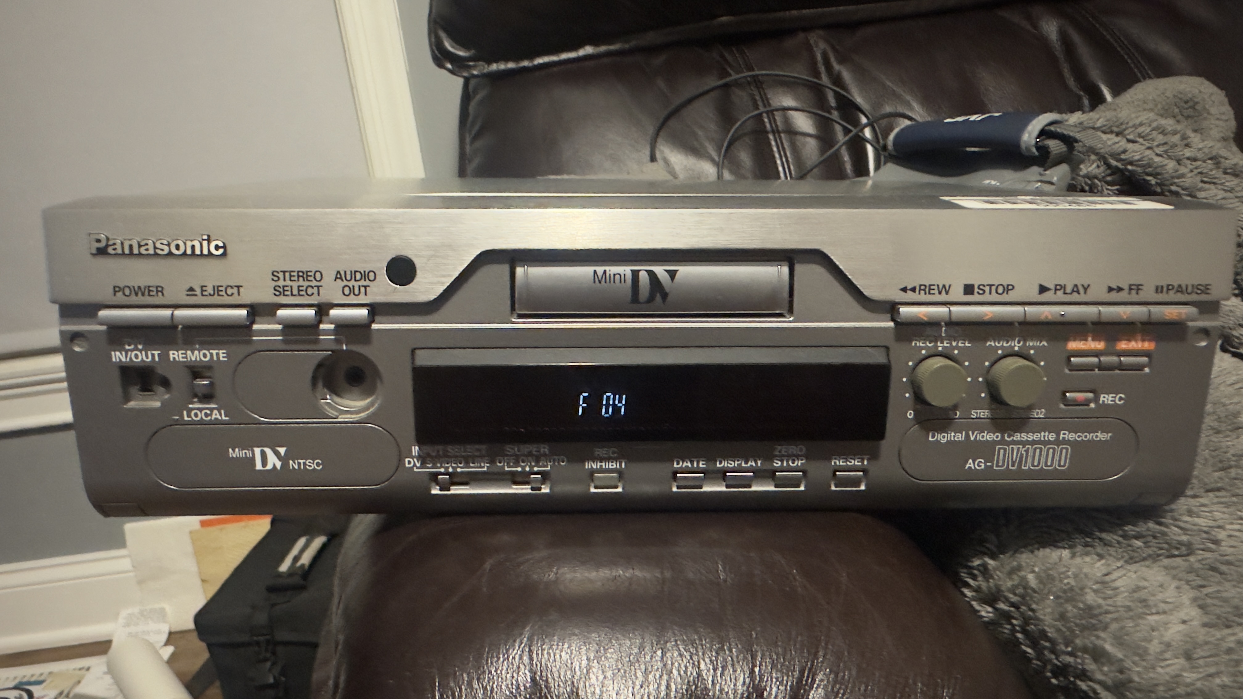

  1. Hello everyone I’m new to this forum. I just got a Panasonic ag1980 and a dv1000.
    On the DV1000, I put a bad tape in, and it jammed it up with the f04 error code.
    I was able to get the tape out gently and successfully.
    But now every time I turn the unit on, I get the F04 code automatically, and I can't use it.
    Is there like a reset feature or something that I have to do?
    I unpluggeed it and let it sit overnight and that didnt help.
    What should I do?
    ThanksImage

    Thank you for the reply. When this unit turns on, it goes straight to the F04 Error and shuts down, leaving me no time to get to the menu to factory reset. But just another piece of information: it was working perfectly before the bad tape was put in, so I'm just hoping some of the motors haven't gone bad. Thanks.

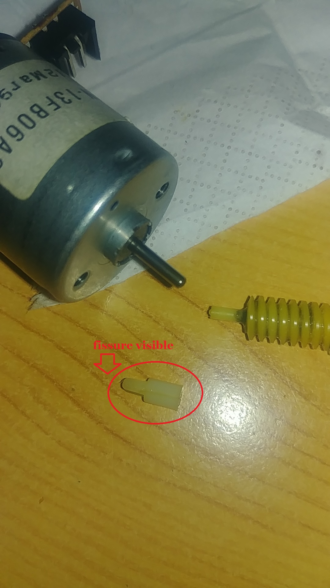

  9. Maybe the coupling of the loading motor is cracked, this happening to me on a panasonic vhs deck not long ago. Solution is to superglue it if that's the case (or better glue , bond kind

  11. You can to move the mechanism by hand and see what happen. If you can't spot cracked gears and it locks at some point i guess you have found the culprit
