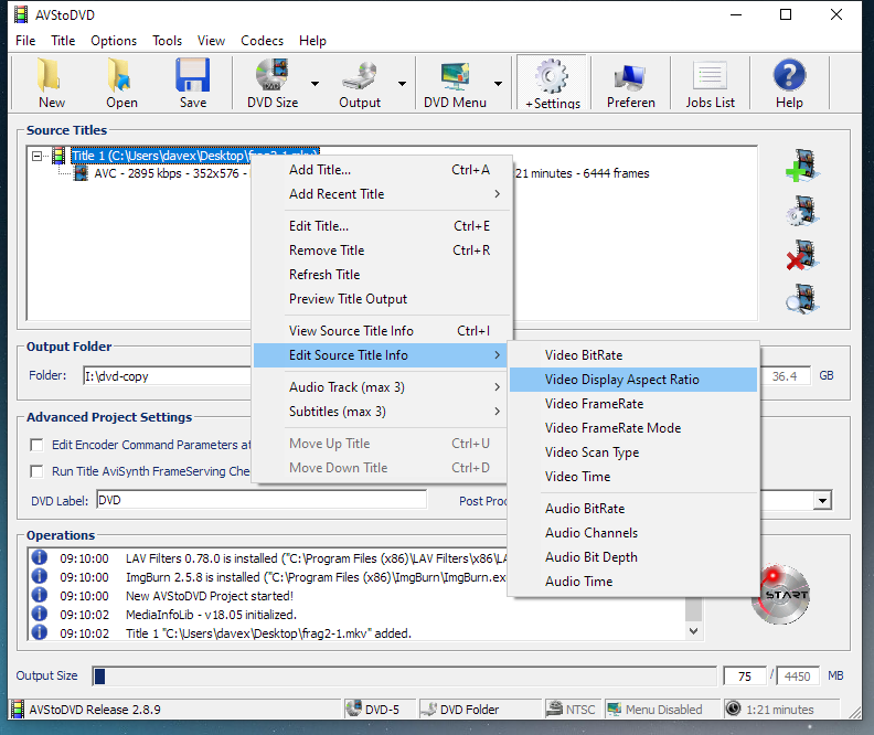

    Thanks. I forgot about AVStoDVD. I have used it in the past. I was thinking that MPEG2 output wouldn't provide good enough quality for a DVD size. I do have some shorter videos to convert and high bitrate MPEG2 encoding should work fine. For longer videos, I'll probably make some H264 output disk as well using Handbrake. I did noticed that AVStoDVD assumed that my source was progressive rather than interlaced and the aspect ratio was wrong as well. I think that the AVI container causes that. I also wanted to also crop the video head switching noise at the bottom of the frame. Therefore I had to edit the encoder command parameters at runtime as described below in the AviSynth script I used:
    DirectShowSource("C:\video.avi")
    # VHS tape captures are assumed to be top field first
    AssumeTFF()
    # Letterbox is used to remove the VHS head switching
    # noise at the bottom of the video frame.
    Letterbox(0,6)
    # If using AVStoDVD then on the main screen
    # hit F8 to show advanced project settings.
    # Select "Edit Encoder Command Parameters at runtime".
    # Assuming that the HCENC video encoder is used,
    # at runtime change the HCENC options to have the below:
    # *INTERLACED
    # *TTF
    # *ASPECT 4:3
    # If present, remove *PROGRESSIVE, *BFF, and other *ASPECT from the HCENC options.
  18. Member

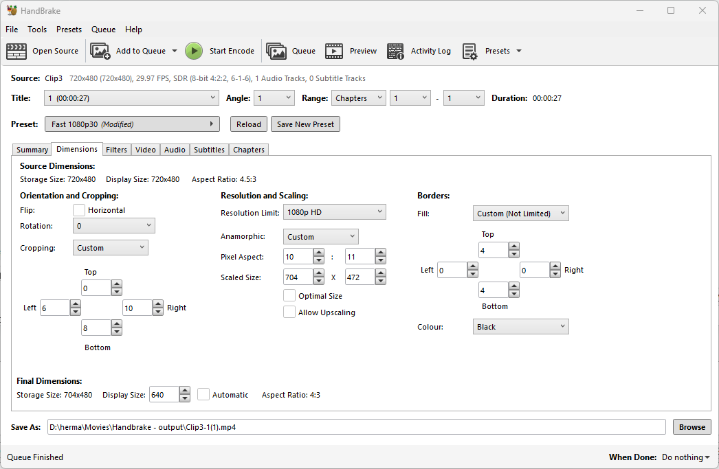

    Okay. Now back to trying to get Handbrake to have the correct display aspect ratio.
    Handbrake reports my AVI file which is interlaced 720x480 as having an aspect ratio of 3:2. It should be 4:3 for final display (NTSC SD).
    I set the output container as MP4.
    I set all Handbrake options to off.
    I set the frame rate to same as source.
    I added the following to the encoder options advanced option box:
    interlace=ttfar=10/11
    Mediainfo is reports the output file as progressive with a 3:2 aspect ratio. It seems like I am not entering the advanced options correctly.
    Handbrake is showing what I entered in its log output.
    Mar 2008
    Aspect ratio can be set in the GUI/dimensions tab
  21. Can't help you with Handbrake.
    Use this ffmpeg commandline instead:
    ffmpeg -y -i "Clip3.avi" -c:a aac -c:v libx264 -preset slow -crf 17 -flags +ilme+ildct -pix_fmt yuv420p -vf "scale=interl=1,crop=704:472:6:0,pad=704:480:-1:-1:color=black,setsar=10/11,setfield=tff,format=pix_fmts=yuv420p" "out.mp4"

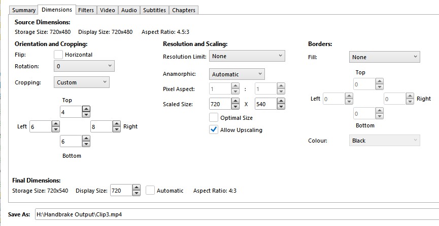

    Sharc taught us this last year. Handbrake cropping and resizing to square pixels:
    [Attachment 85880 - Click to enlarge]

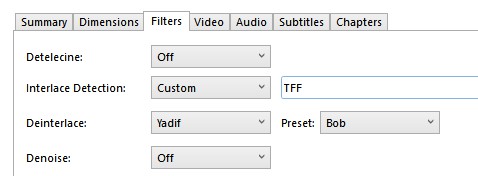

    My Deinterlace settings for Yadif (I typed in "TFF"):
    [Attachment 85882 - Click to enlarge]

    Last edited by Alwyn; 2nd Mar 2025 at 21:41. Reason: Added Deinterlace settings image
  24. Here the Handbrake settings for non-square (anamorph) encoding with PAR 10:11, DAR 4:3.
    I gave up on it because it treats the chroma badly for interlaced 4:2:0 encoding. The chroma advances at framerate only instead of fieldrate. Same for the DVDStyler encode of post#16 btw. Maybe something goes wrong when doing the 4:2:2 to 4:2:0 conversion in ffmpeg mpeg2, and/or because HB seems to always flag interlaced video as progressive. I didn't analyze it further.
    The ffmpeg commandline of post#21 handles the chroma correctly. (Similar can be done in Avisynth of course).
Name:	HB anamorph.png
