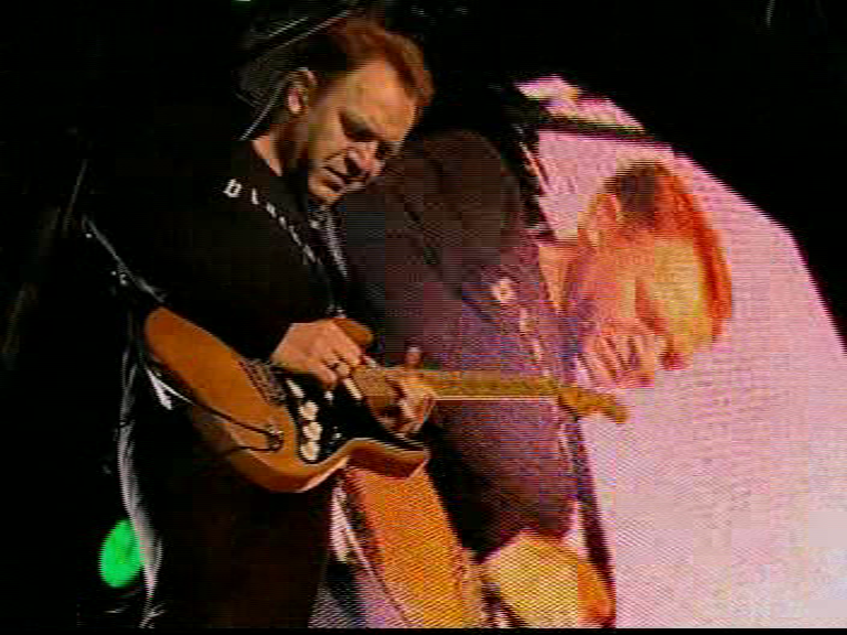

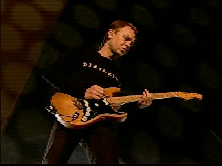

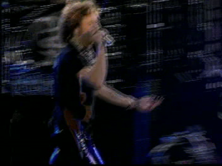

  1. Interlaced video, with compression artifacts like blocking artifacts that stand out when the lights reflect the camera, with a resolution of 352x576. I was thinking of using artificial intelligence, but I don't know what filters can make this video look better before rescaling, and I don't know which model would be the best either.

    The fragment was cut with avidemux without re-encoding
    The concert is over 1 hour long, unfortunately I can't upload it in full but basically it contains all those compression artefacts and gradually depending on the scene it increases the block artefacts, something I have not been able to solve correctly in any video I have tried to improve visually apart from this one in particular.
    File: X:\X\X\X\fragment.mkv | Format: Matroska v4 | Size: 29.4 MiB | Duration: 1:20 min | Bitrate: 3 054 kb/s
    Encoded with: Lavf58.76.100

    For interlacing I'm using QTGMC(preset=‘Slower’) visually it has no problems after that, however the blocking artifacts and resolution sucks, it's very bad quality and most likely if I try to remove the blocking artifacts it will look terrible, even with artificial intelligence the quality is fluctuating it's very difficult to make the video visually stable without adding more artifacts from removing them. I think it's going to be tricky, but I'll wait for some responses to this thread.
