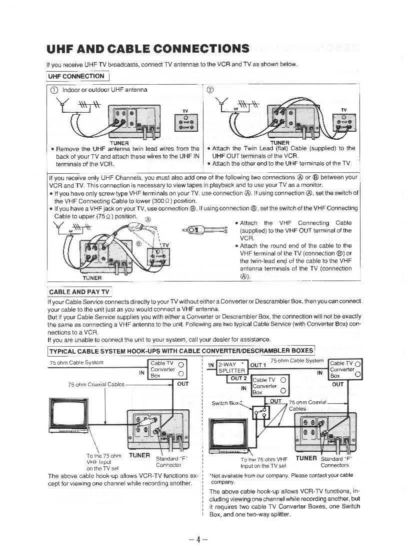

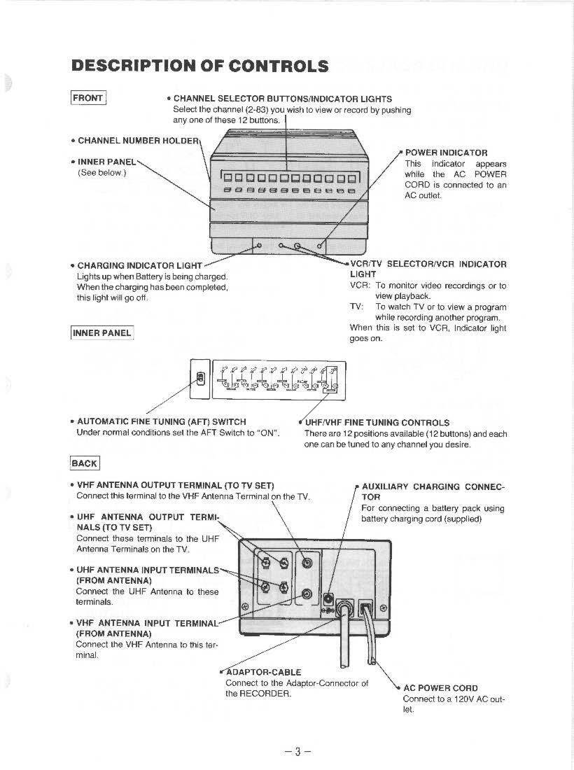

    See if there is anything useful here
