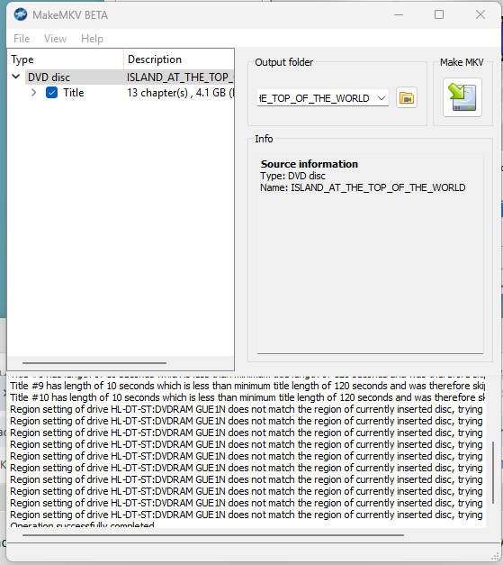

  8. Tried downloading it again and got this message using makemkv.
    It is already in the right region. Region 1. Why is it still saying not in the right region?

    Feb 2006
    the error you are getting "Scsi error - ILLEGAL REQUEST:READ OF SCRAMBLED SECTOR WITHOUT AUTHENTICATION"
    run Makemkv "as administrator" see if that works.
    see this thread for more info - https://forum.makemkv.com/forum/viewtopic.php?t=15877
