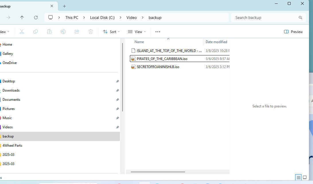

    I see you're ripping your DVDs to your C drive. I wonder if that is causing some of the issues.
    Try moving that latest good ISO onto another internal drive, if you have one, then see if Imgburn will pick it up.

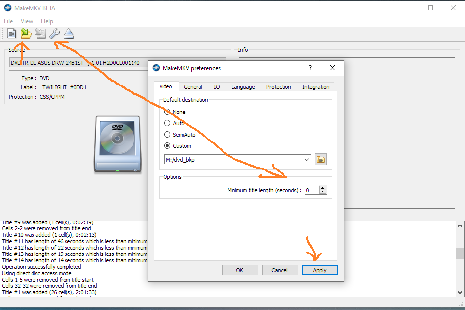

  13. When downloading I get a lot of these: Title #1 was added (14 cell(s), 1:33:38)
    Title #3 has length of 4 seconds which is less than minimum title length of 120 seconds and was therefore skipped
    Title #5 has length of 8 seconds which is less than minimum title length of 120 seconds and was therefore skipped
    Title #6 has length of 16 seconds which is less than minimum title length of 120 seconds and was therefore skipped
    Title #7 has length of 90 seconds which is less than minimum title length of 120 seconds and was therefore skipped
    Title #9 has length of 110 seconds which is less than minimum title length of 120 seconds and was therefore skipped

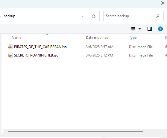

  15. Turn off Windows Explorer's "Hide Extensions For Known File Types" option. From any Explorer window select View -> Options -> View (tab) -> Advanced Settings -> Hide Extensions For Known File Types. See if that makes any difference. At least you'll be able to see the real extensions.
    Mar 2008
    Nothing wrong with Imgburn. If you're concerned about titles less than 120 seconds being dropped when the disk is ripped,
    you can set the seconds to 0 (so nothing will be dropped) in the preferences\video tab

  17. Thanks Davexnet for that tip!! I will go make that adjustment and re download my DVD’s. Good thing I only have 2 to redo. Glad I asked that question. Thanks so much for including the illustration!

  19. Guess What. Member Alwyn figured out why ImgBurn was not recognizing my Iso's of my 2 DVD backups usinf Makemkv. So now I am going to try and Burn the Iso in test mode of the one on a DL disk that id 4.71 GB.I just hit start in test mode. we will see what happens next.
    Thanks for finding that dvd. They are hard to find. I was able to get a good download of it too. I still don't kno2w how to check a makemkv log. Thanks for all the work you did on it!
  20. Originally Posted by zipsick View Post
    Guess What. Member Alwyn figured out why ImgBurn was not recognizing my Iso's of my 2 DVD backups usinf Makemkv!
    What was it that Alwyn figured out ?

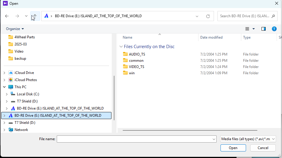

  21. Well I tried a test mode on a good Iso using ImgBurn. I got a message saying tray open and Disc not empty. I checked properties on disc. attachment shows properties. I don't understand all the copies files but got one of them to open the movie and it played using KMPlayer 64X. I attached a copy of the choices KMPlayer gave me to choose to pick for which file to open to play the DVD. Which file plays the dvd. I kept trying them until I got lucky. I need to know for the next time. I did this in test mode so don't know how this made a playable dvd. Can you explain this to me? Do I have to do it again not in the test mode?
    Thanks for getting the DVD and test ripping it for me with all the info. I really appreciate it! how did you find it? It is not easy to find.

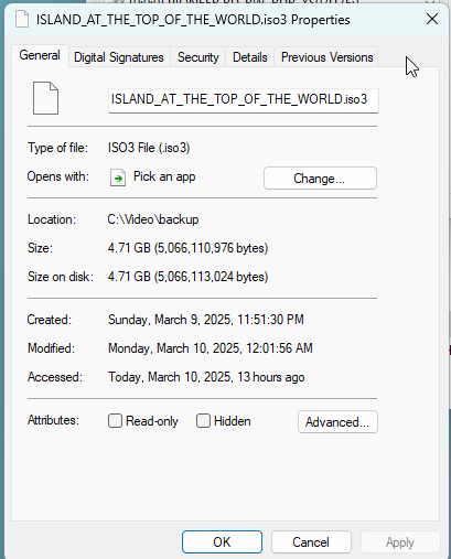

  22. I tried playing the test dvd on a dvd player and it works great. But it was written as a test. What does all this mean? Will it be ok?
  23. Originally Posted by zipsick View Post
    I'm surprised the "ISLAND_AT_THE_T0P_0F_THE_W0RLD.iso3" would even load.
    .iso.3 should not be an extension. It should be .iso only.
    I suspect it is the third .iso MakeMKV created.
    It should have been something like this: "ISLAND_AT_THE_T0P_0F_THE_W0RLD(03).ISO

  24. So you know. Before I test Ran the burn I dropped the “3” after name on the ISO.
