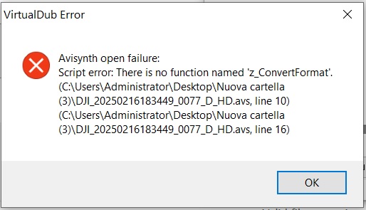

    but I get
    [Attachment 85639 - Click to enlarge]
    what can it be?
  12. You need to put avsresize.dll into the Avisynth plugin folder.
    http://avisynth.nl/index.php/Avsresize

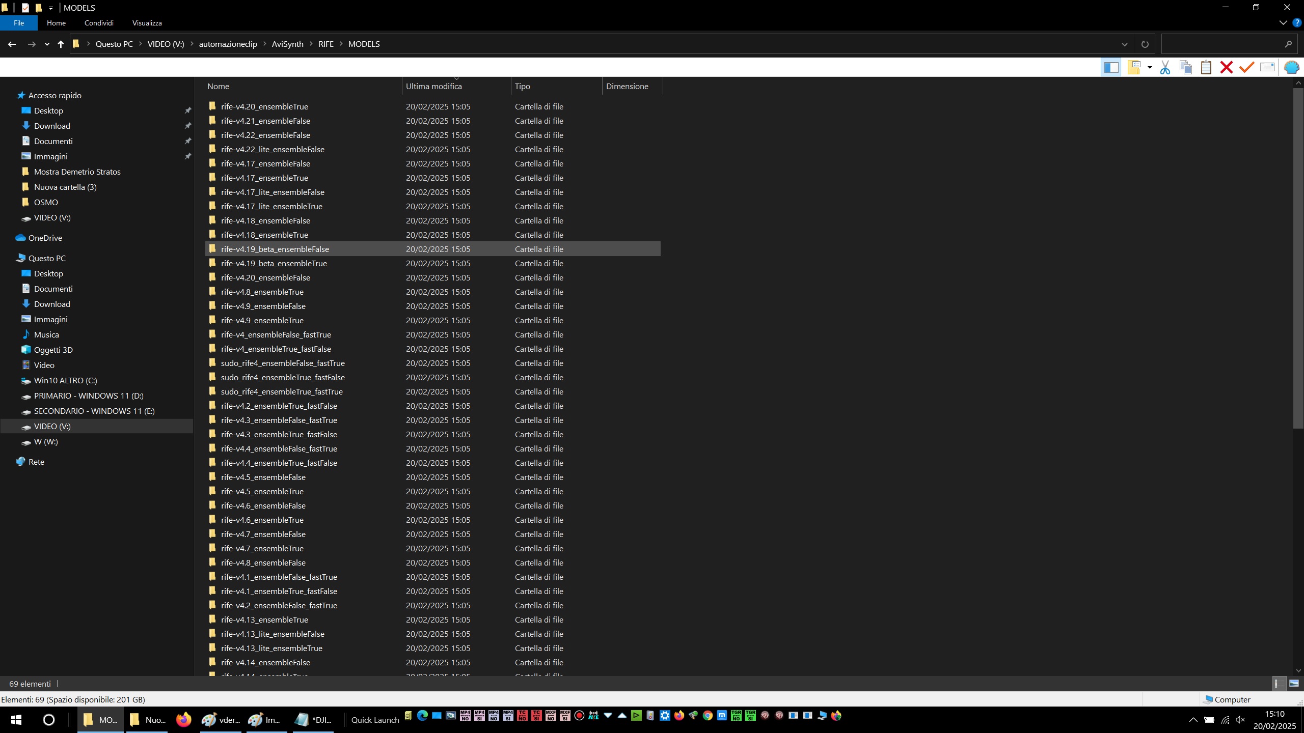

    I have installed
    --> AviSynthPlus_3.7.3_20230715.exe
    --> download RIFE-1.2.2.7z and placed RIFE.DLL in a specific folder
    --> download avsresize_r21.7z and placed avsresize.dll in a specific folder
    --> download models_from_0_to_52_and_sudo.7z and models_from_53_to_65.7z and decompress to the RIFE folder
    this is the script:

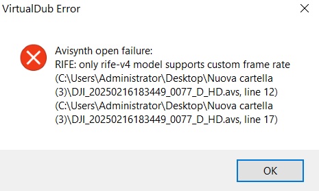

    but I get this error:
    [Attachment 85645 - Click to enlarge]

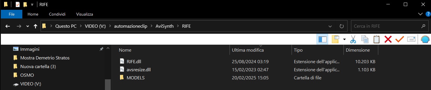

    I have locate the rife.dll and avsresize.dll as here
    [Attachment 85646 - Click to enlarge]
    and create a sub folder as here
    [Attachment 85647 - Click to enlarge]
    re-try to load this script:

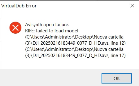

    but I get:
    [Attachment 85648 - Click to enlarge]
    what can it be?
  15. I try to use model=11 instead of model=9
    don't know the differences but virtualdub open the avs

    p.s.: at the moment I use model=11 in RIFE to avoid the "only rife-v4 model support custom frame rate" when using model=9
