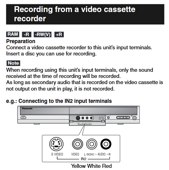

    Note: I suggested to use the front sockets of the ES10 (IN 2) as an alternative to the inputs on the back in the hope that this may solve the sound problem)

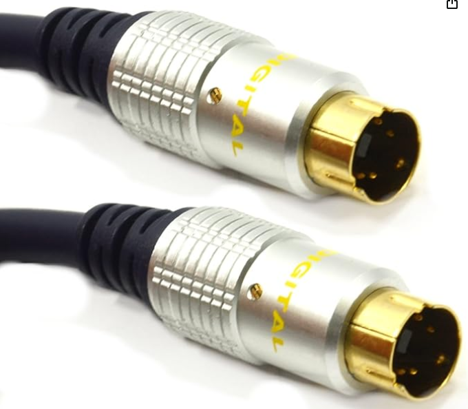

    Great. I hate to be a pain but can you tell me which S-Video cable to buy. My VCR does not have a S-Video connection but I'm getting another one next week a Panasonic NV-VP60 which has a S-Video connection.
    Also where do you enable the comb filter in the settings?
    Thank you
  8. Originally Posted by TazDave View Post
    ...can you tell me which S-Video cable to buy. My VCR does not have a S-Video connection .....
    something like this, e.g. from amazon
    [Attachment 85605 - Click to enlarge]
    In your current setup use it for connecting the ES10 (S-video OUT socket on the rear) to the USB-live2, instead of the YELLOW.

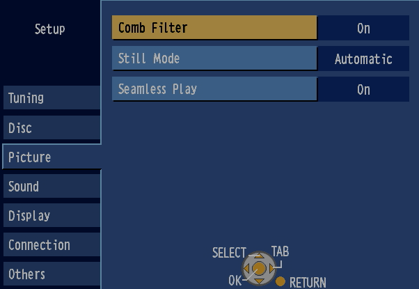

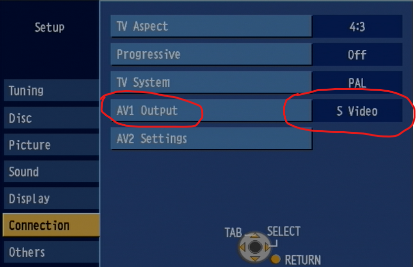

    Menu of the ES10:
    [Attachment 85606 - Click to enlarge]

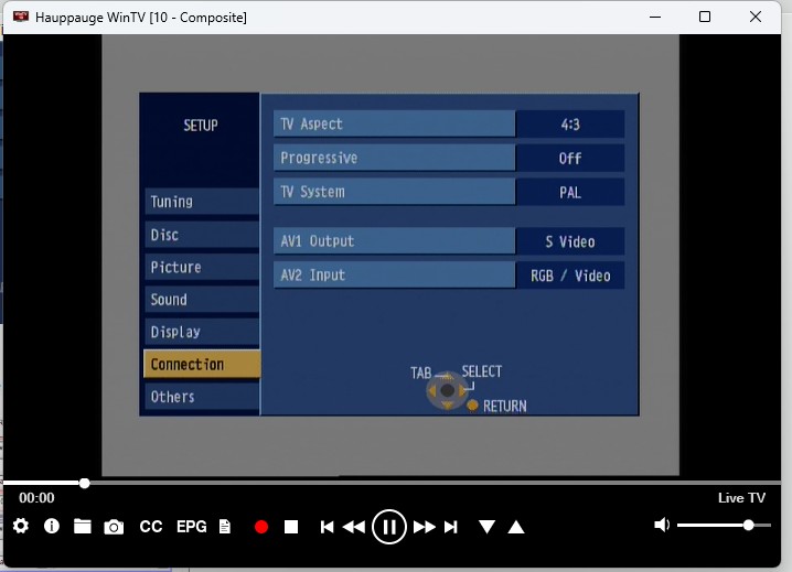

  11. You need to set the ES10 to S-Video (Screenshot is from ES15 but it will be same/similar for the ES10)
    [Attachment 85732 - Click to enlarge]

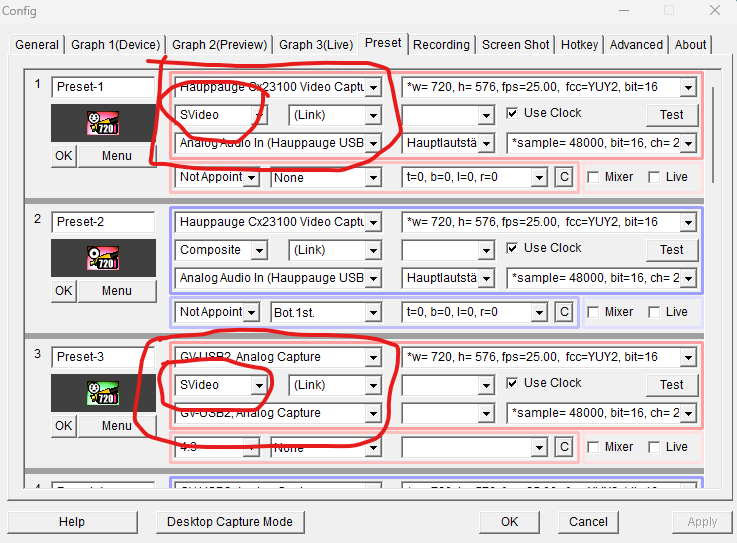

    And in your capture SW (picture below is for AmarecTV) you have to select S-Video as well for your capture device:
    [Attachment 85733 - Click to enlarge]

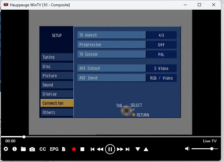

    Thank you for the quick reply, I tried all that but I only get sound & no picture.
    I have attached a screenshot of my connection, maybe you can see something else there I need to changeImage
    [Attachment 85754 - Click to enlarge]

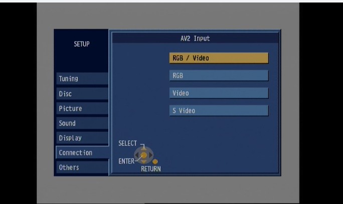

  13. I don't have the ES10, I have the similar ES15 only, but:
    a. what menu options do you have for the front AV2 Input of the ES10?
    b. I found a confusing Note in the ES10 manual for the AV2 Input:
    [Attachment 85762 - Click to enlarge]
    So you may have to try again the Input on the rear for the ES10 (?!?). Set it to something like "Video" or "Composite" in the menu of the ES10.
    c. You also need to configure the capture device for S-Video rather than Composite (see my 2nd screenshot in the former post).
    (I understand you set it to Composite for the sake of your screenshots as this was the only one which worked).
    Maybe someone with an ES10 will chime in.

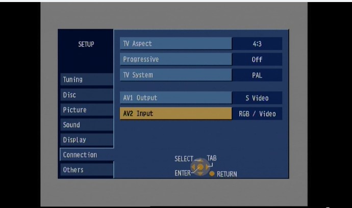

    Feb 2017
    Australia
    On the front of the ES10 the 0nly inputs I get are A1 to A4
    I have attached a screenshot of the AV2 Input.
    I did change video to S Video but still the same.
    My currrent cable configuration is -
    There are no cables connected left rear side of ES10 which is AV2 in which I thought I had to disconnect.
    The right rear hand side of the ES10 which is Video Out I only had the yellow cable from the VCR plugged in because the S Video was only playing sound.
    The red & white cable from the VCR is connected to the USB Live-2
    As mentioned above I plug the yellow cable from the VCR into the USB-Live 2 to get picture..
    Now I've totally messed the cable configuration up from my original setup to accomodate the S Video cable I no longer know where I shuld put them.
    I hope all the above makes sense.
    Thank you
Name:	Dmr-ES10 AVI2 Menu.jpg

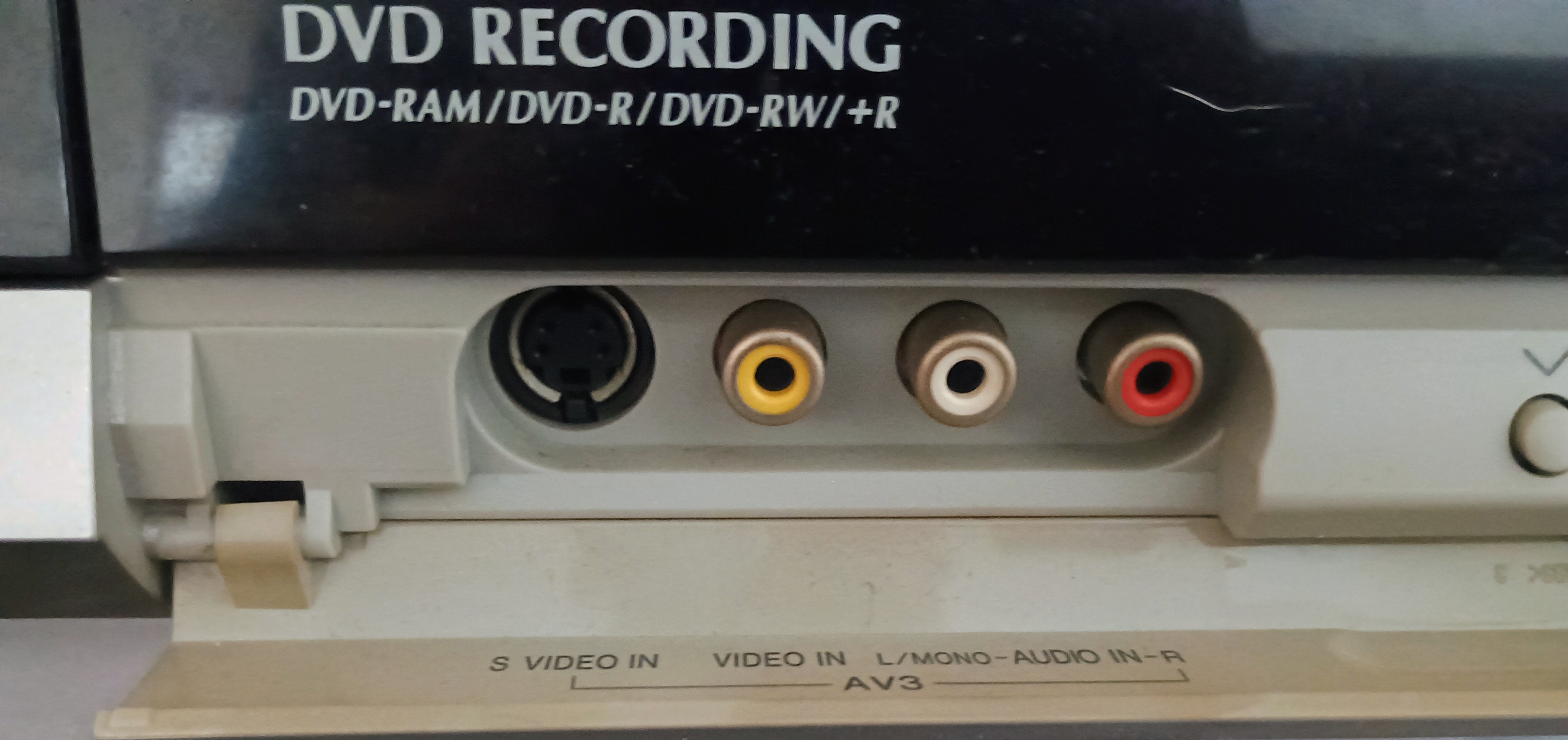

  15. We start from scratch then and try step by step.
    - Upload 2 photos of your ES10 box: front view and rear view where we can see the connectors (sockets).
    In the meantime:
    - Connect your VCR to the front red+white+yellow of the ES10 (your VCR has no S-video)
    - Connect the S-video cable from the S-video out which is on the rear of the ES10 to the S-video socket of the USB live-2

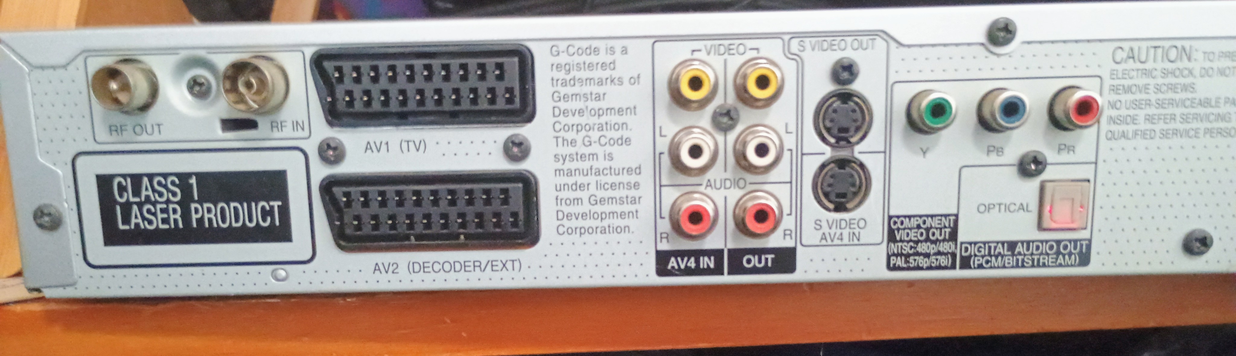

    I tried your suggestion, all I got was a bad screen which I attached a screenshot.
    I have also attached a screenshot of the front & rear connections & current connection settings.
    Thank you
Name:	Capturing With Red White & Red Cables Front ES10.jpg
Name:	ES10 Rear Inputs.jpg
Name:	ES10 Front Inputs.jpg

  19. - Fist picture is your VCR, right? Is it the NV FY600?
    - Second Picture is the front of your ES10, thst's ok.
    - Picture of the rear of the the ES10 is missing, but anyway:
    Did you ever configure your USB-Live2 to for S-Video? See the 2nd picture in post#11.
    You need to do these settings in AmarecTV (or whatever capture SW you are using).
    May 2005
    Australia-PAL Land
    No it's not. It's the middle one, with all the S-Video and Scart ports.
  21. Originally Posted by Alwyn View Post
    ok, my bad, sorry.
    @TazDave:
    So you connect "S-VIDEO OUT" on the rear of the ES10 -> S-Video connector of the USB-Live 2
    and
    AUDIO OUT WHITE (L) + AUDIO OUT RED (R) on the rear of the ES10 to the white and red connectors of the USB-Live2
    But you never answered the question:
    So again: Did you configure your USB-Live2 for S-Video? What capture SW are you using? AmarecTV? VirtualDub? The one which was shipped with the USB-Live2 (AFAIK it is called "Hauppauge Capture")? Something else?
    If you don't know how to do it we have to continue from there .....

    From your earlier screenshots it looks like you are using Hauppauge WinTV as your capture SW. I don't use it, but there should be settings where you can change from "Composite" to "S-Video". So check this out first.
    Next would be to use a better capture SW for capturing lossless. But that's for later .....

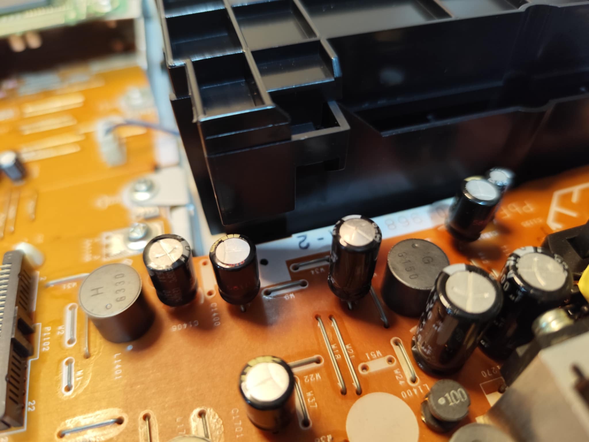

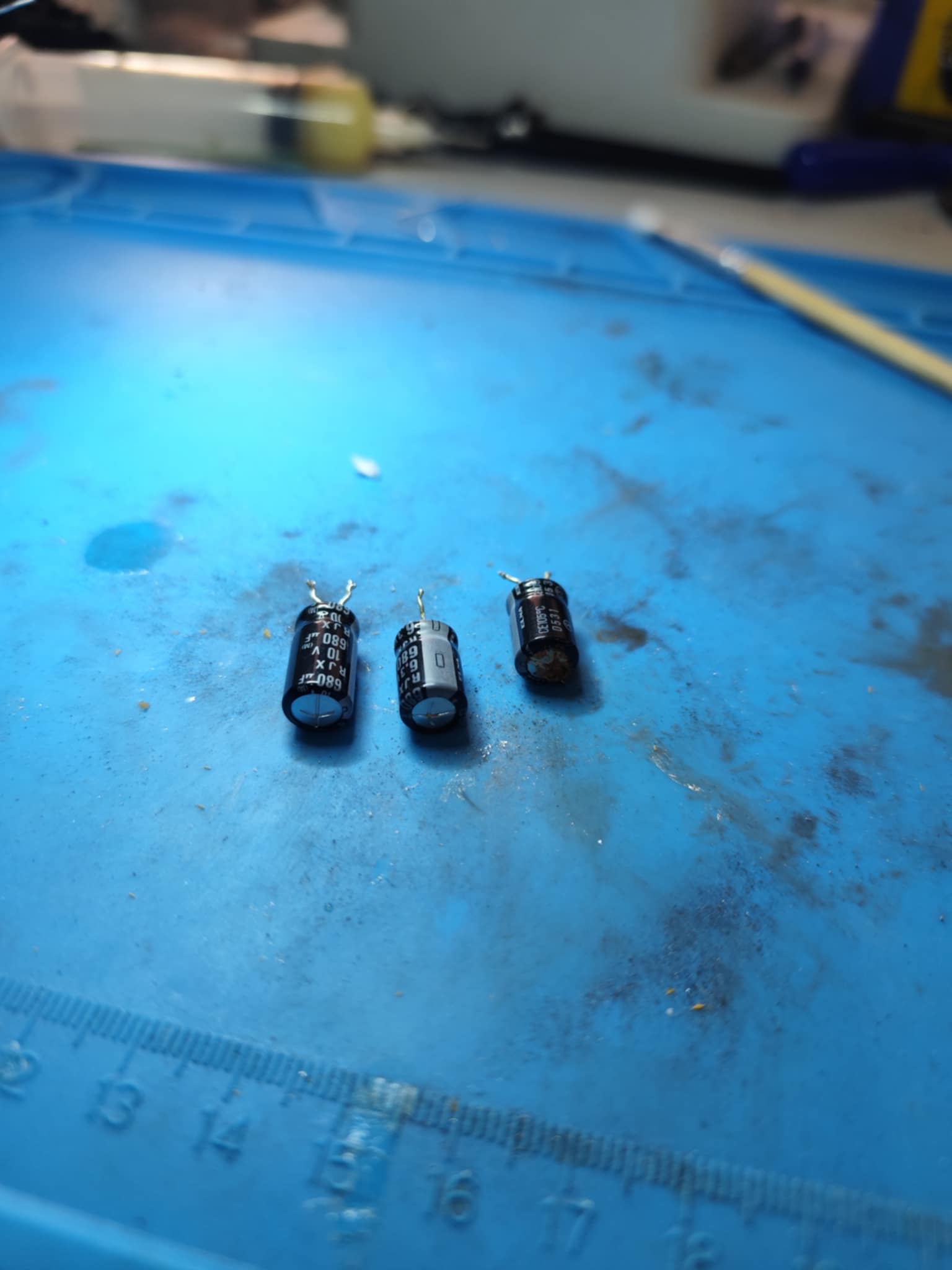

    He replaced the caps on my original ES10 & It's working great. I have attached a photo of the caps that needed replacing.
    I gave him this one & he sent me a photo of the faulty caps on that one & intends to replace them as well. I have attached a photo of those caps as well.
    I highly appreciate everyone's help but I don't think it was ever going to work no matter what we did until the caps were replaced.

    [Attachment 85803 - Click to enlarge]
    [Attachment 85804 - Click to enlarge]
