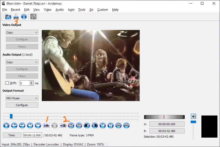

    It just means cut a short clip from your capture and post it here.
    You can use Avidemux to extract a clip. Use the A and B buttons to set the cut-in and cut-out points,
    then the button above to save the clip.
    Then use the "Upload files/Manage attachments" button to upload it to the forum
