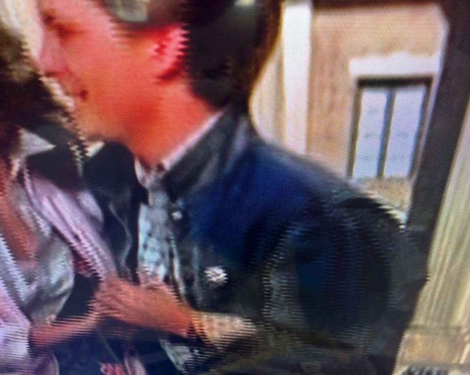

Here's a photo of my display playing on the Onn direct play through a gigiabit LAN of the .mkv ripped directly from the disk
[Attachment 85458 - Click to enlarge]

It is playing through a plex app. I can look at the decoder, but I believe it's android based.
TFF/BFF is all ok. I'm asking about a good basic deinterlacing script. I certainly understand the concern to not deinterlace at all, but that is something else i'm looking at.

Something like this is sufficient for most videos:
Be sure not to resize before deinterlacing. If you crop before deinterlacing be sure to crop by even values on the vertical axis. Otherwise you will reverse the field order. Some source filters don't handle MPEG 2 video in MKV properly. And loss of sharpness isn't the usual complaint about QTGMC -- too much sharpening is. Post your entire script.Code:LWlibavVideoSource("filename.mkv") QTGMC()
Thin horizontal lines are sometimes confused with interlacing and blurred (or moire) by QTGMC. Lossless mode can sometimes prevent that. But you get less effective deinterlacing elsewhere -- typically seen buzzing edges.
There's no way Back to the Future was shot as interlaced video. Maybe you have a PAL/NTSC conversion?Last edited by jagabo; 13th Feb 2025 at 17:48.
