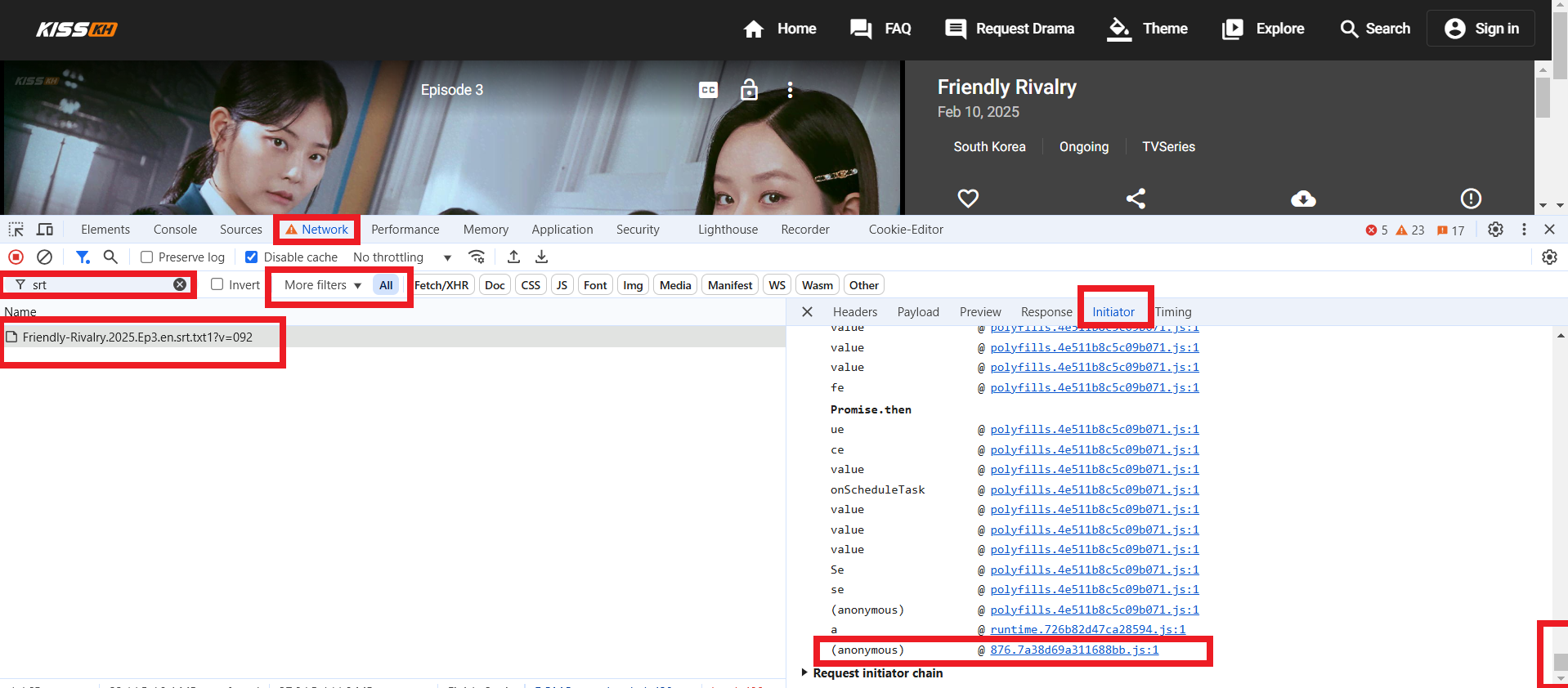

    Use chrome. Identify the js file responsible for the srt by scrolling downwards.
    [Attachment 85429 - Click to enlarge]

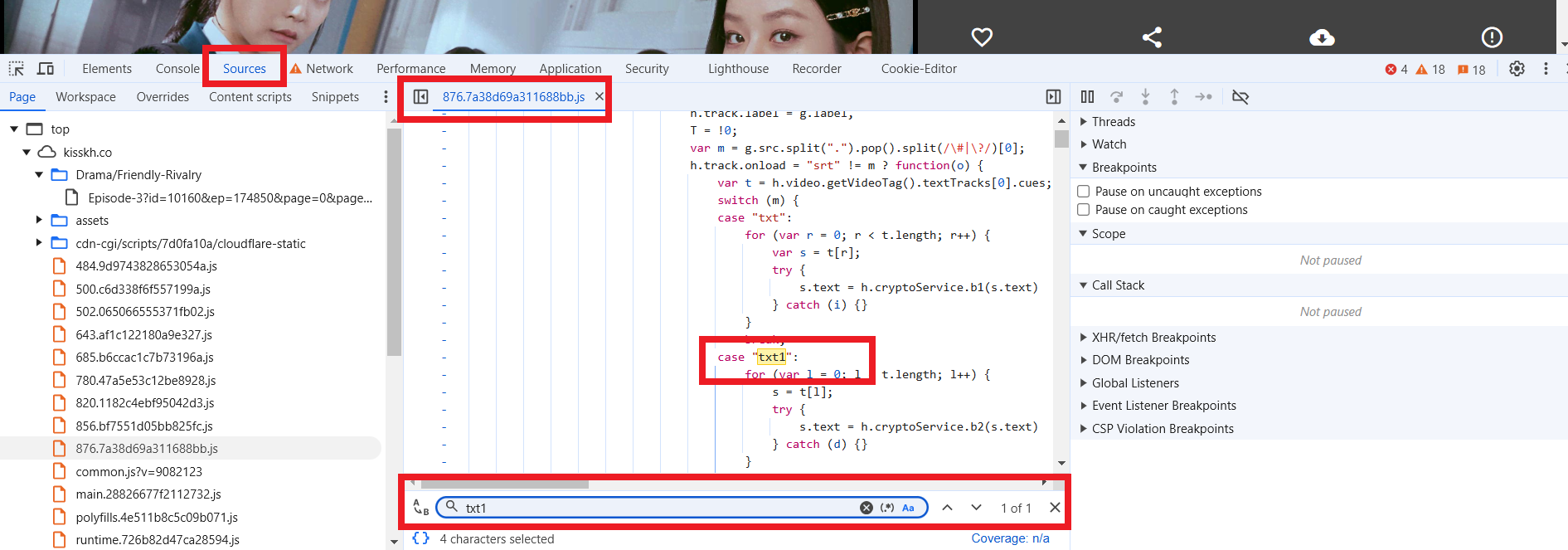

    Click on it. You'll be redirected to the sources tab. Ctrl+f search txt1
    [Attachment 85430 - Click to enlarge]
    The code of interest should look like

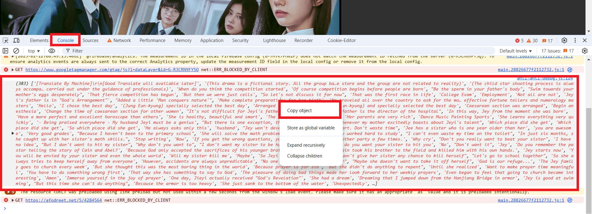

    Make sure enable local override is checked. Ctrl+S to save and overwrite js code. Ctrl+shift+f5 to force refresh without cache and play the video. Choose the subtitle you want and in the console tab you'll see a list of decrypted dialogue lines. Right click copy object.
