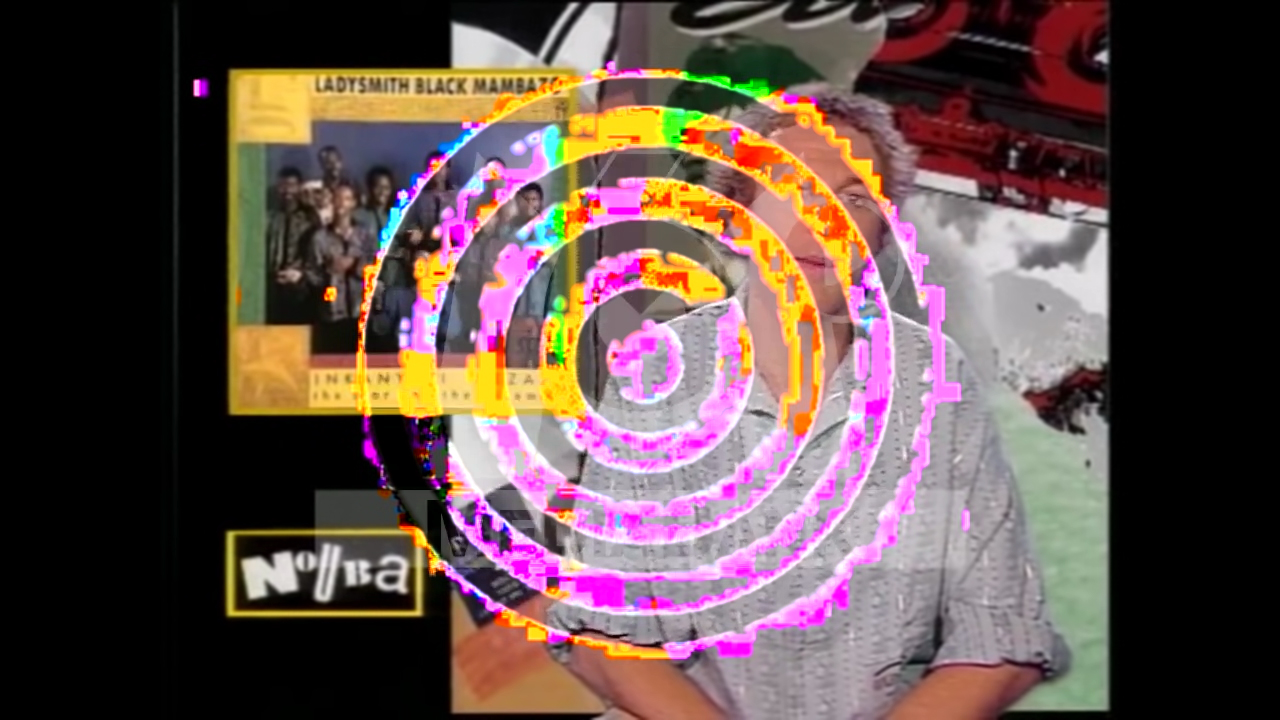

  1. I will post some samples if needed, but hoping this is an easy issue to solve. I have a logo.bmp with a perfectly white logo, and an AVI file. Using the following script does work (I guess) but rather than a grey logo, there are neon colors inside the logo. Darks are purple, skin is pink, etc. The rest of the picture is fine, but the delogoed part is weird. What am I missing?
    avisource("clip.avi")
    inpaintdelogo(mask="D:\mask6.bmp",Loc="788,400,-672,-410", Automask=0, Mode="Deblend")
    FWIW, Inpaint doesn't have the color issue, but since the logo is semi-transparent, Deblend would have a better result. Thanks!

  3. Ok, here is my entire test directory: https://we.tl/t-Mcbuo0r74A
    I used Automask=1 to create the mask, not sure why it made a dartboard, but this is a test so that part doesn't really matter right now. You can see the crazy colors within the mask:

    Your video is less than 2 minutes and logo takes ~half of the screen.
    InpaintDelogo can't remove such automatically, usually you need ~hour long video and smaller logo to remove it automatically. So you would need to do that manually.
    Btw, the logo is not "semi-transparent", it's just transparent.

    "the colors neon" is irrelevant to your issue.
    Btw, in your test you didn't set Loc and the basemask doesn't contain logo at all.
    Originally Posted by kinglerch View Post
    Also what does "do that manually" mean? Like, go into Photoshop and remove each pixel by hand? Or create the mask manually? Or use another tool entirely?
    That means you have to make the masks manually, you can do that with InpaintDelogo, Photoshop & ect. To do that you would need to understand the delogo principles and InpaintDelogo parameters.
