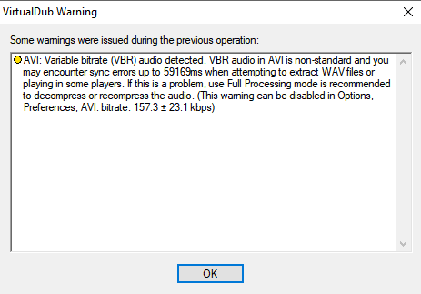

    3. Sometimes VirtualDub gives me the VBR Warning. (Posted below.) What can I do about this when it comes to edits?
    [Attachment 85409 - Click to enlarge]
    Thank you so kindly in advance.

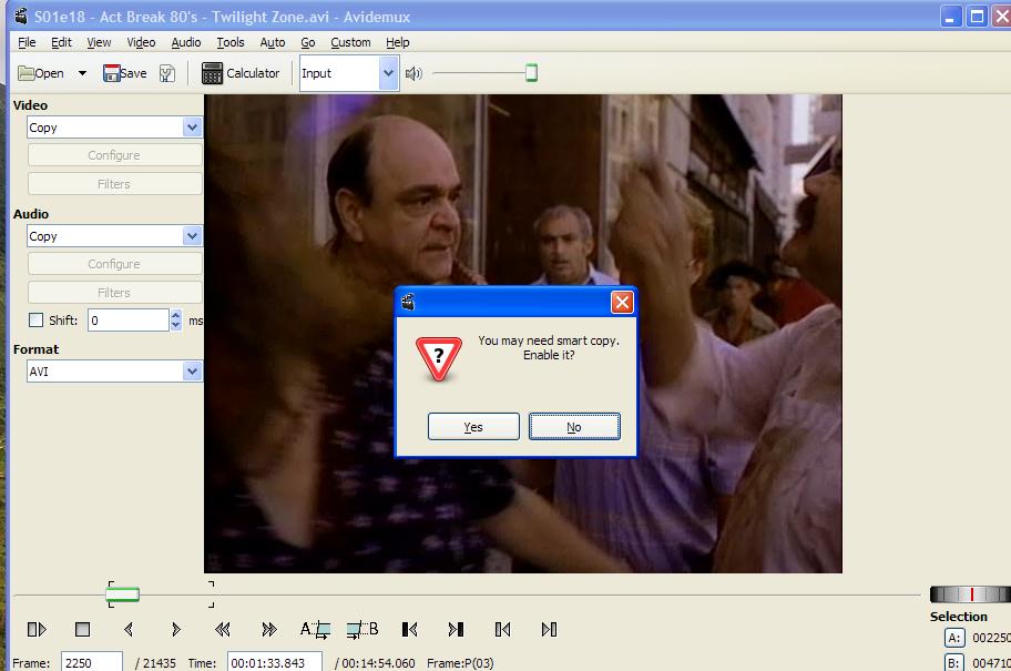

    Try this version of Avidemux, install the gtk version, it seems to work
    https://www.videohelp.com/download/avidemux_2.4.4_win32.exe
