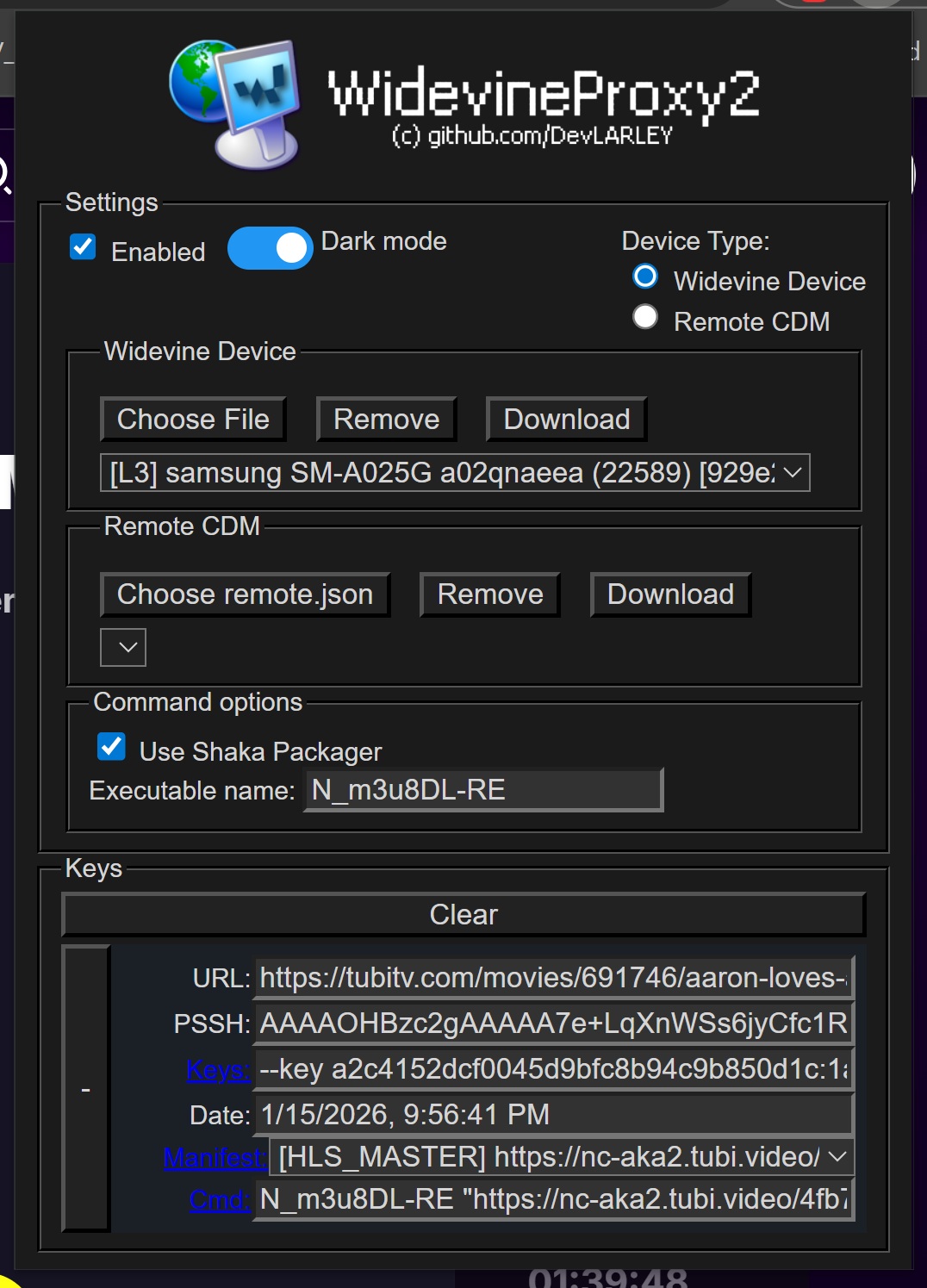

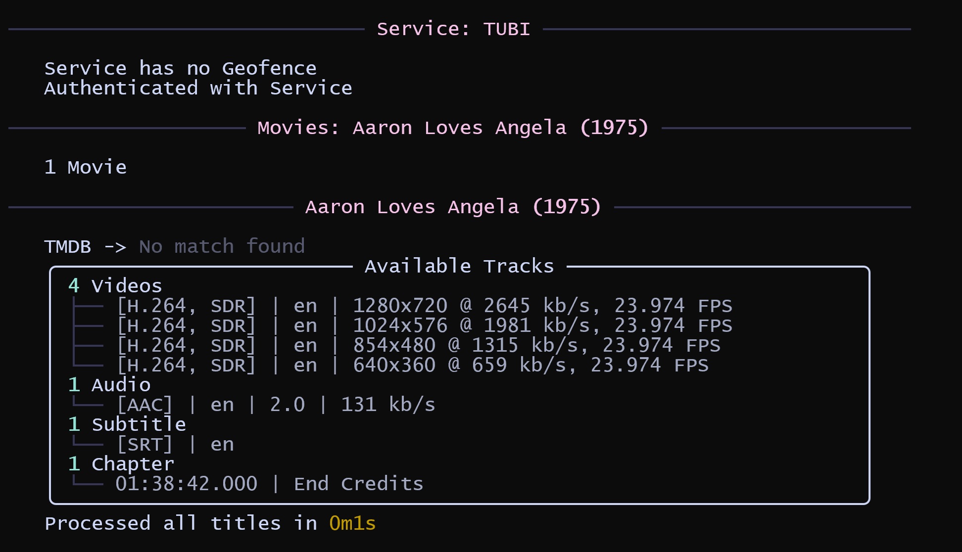

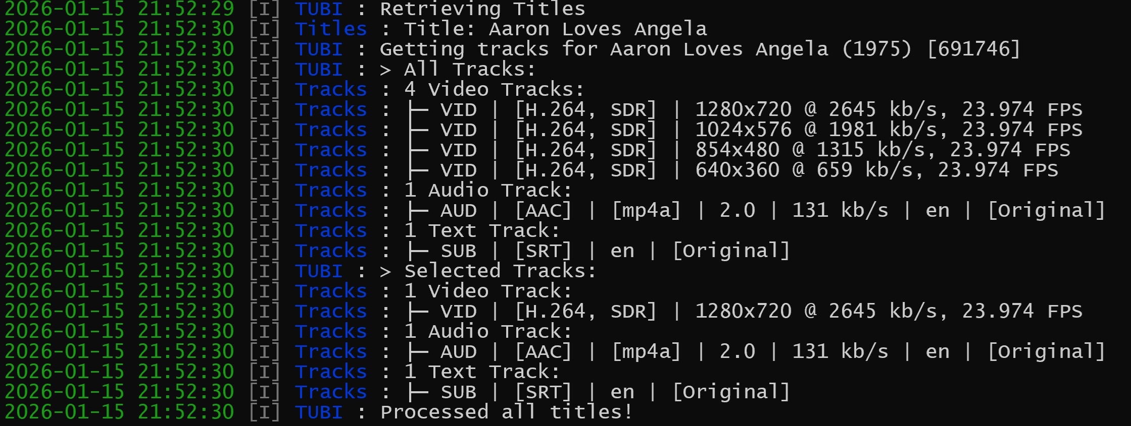

    Dec 2021
    england
    Originally Posted by Lupine Assassin View Post
    One quick request, please. I tried grabbing it with StreamFab, but couldn't: https://tubitv.com/movies/691746/aaron-loves-angela Thanks in advance.
    why.... why streamfab?
    It a crap tool.
    3 tools can get it
    [Attachment 90839 - Click to enlarge]
    [Attachment 90840 - Click to enlarge]
    [Attachment 90841 - Click to enlarge]
